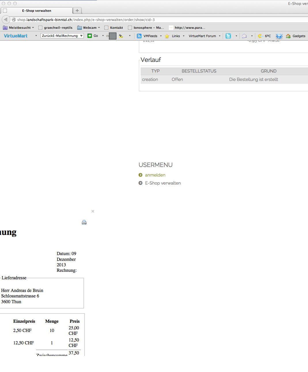

Hello
In the backend work the Invoice button fine, but in the frontend the pop-up not opens correct
Thanks!

You have a popup problem in HikaShop.
Please change the option "popup mode" in your HikaShop configuration so all popup related to HikaShop and HikaMarket will display fine in the front-end.
I think you are using the "boostrap popup" mode but your template is not compatible with. So using the "mootools" mode will be better.
