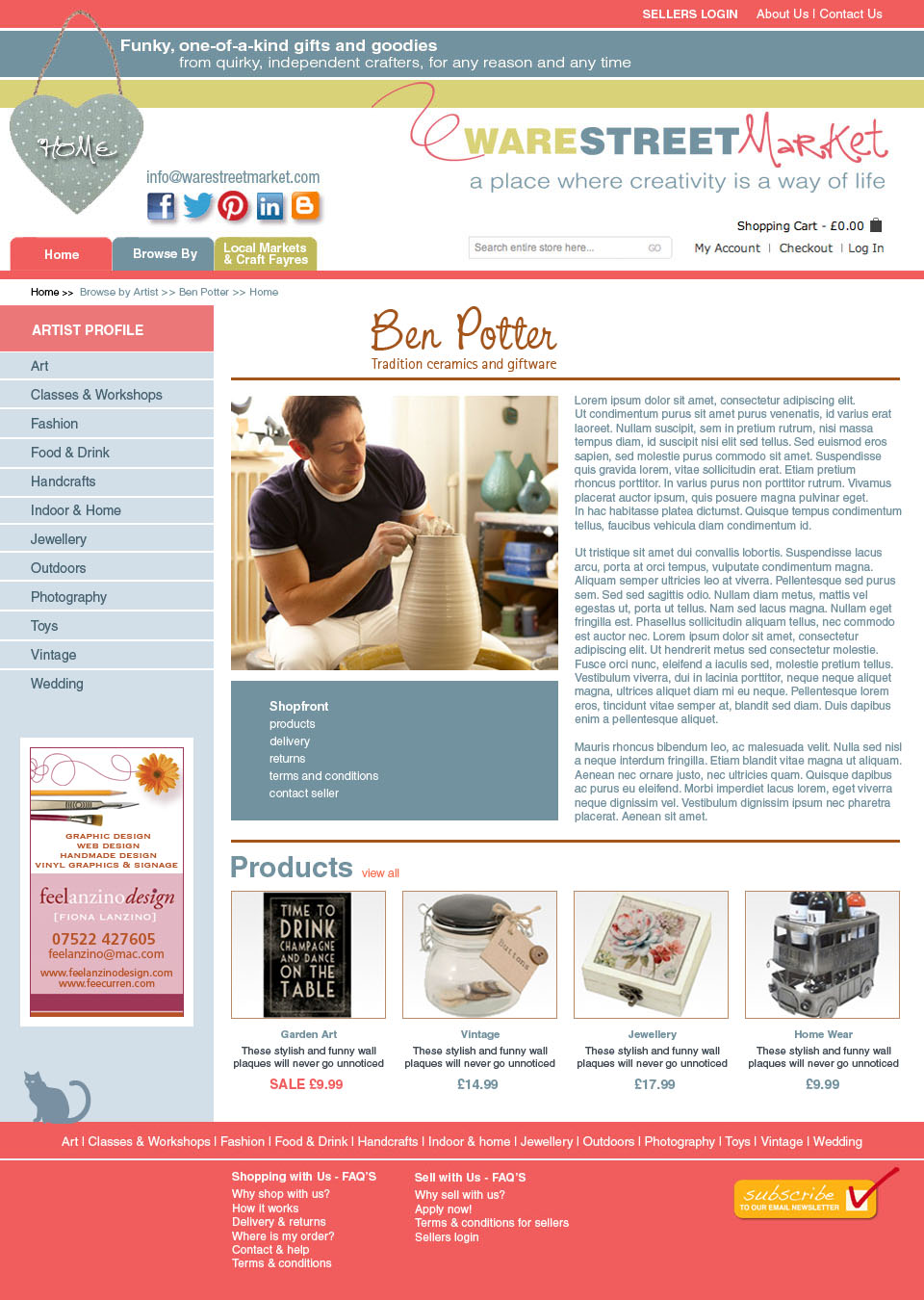

When the vendor ends up with say 100 products, how do i use this module to show them all? The design i have been given for the seller page is attached. So the seller may list all their products, is there a way to do that because hikashop forces you to list the number of products it will show, or is there a way of pagination after say 50 products?

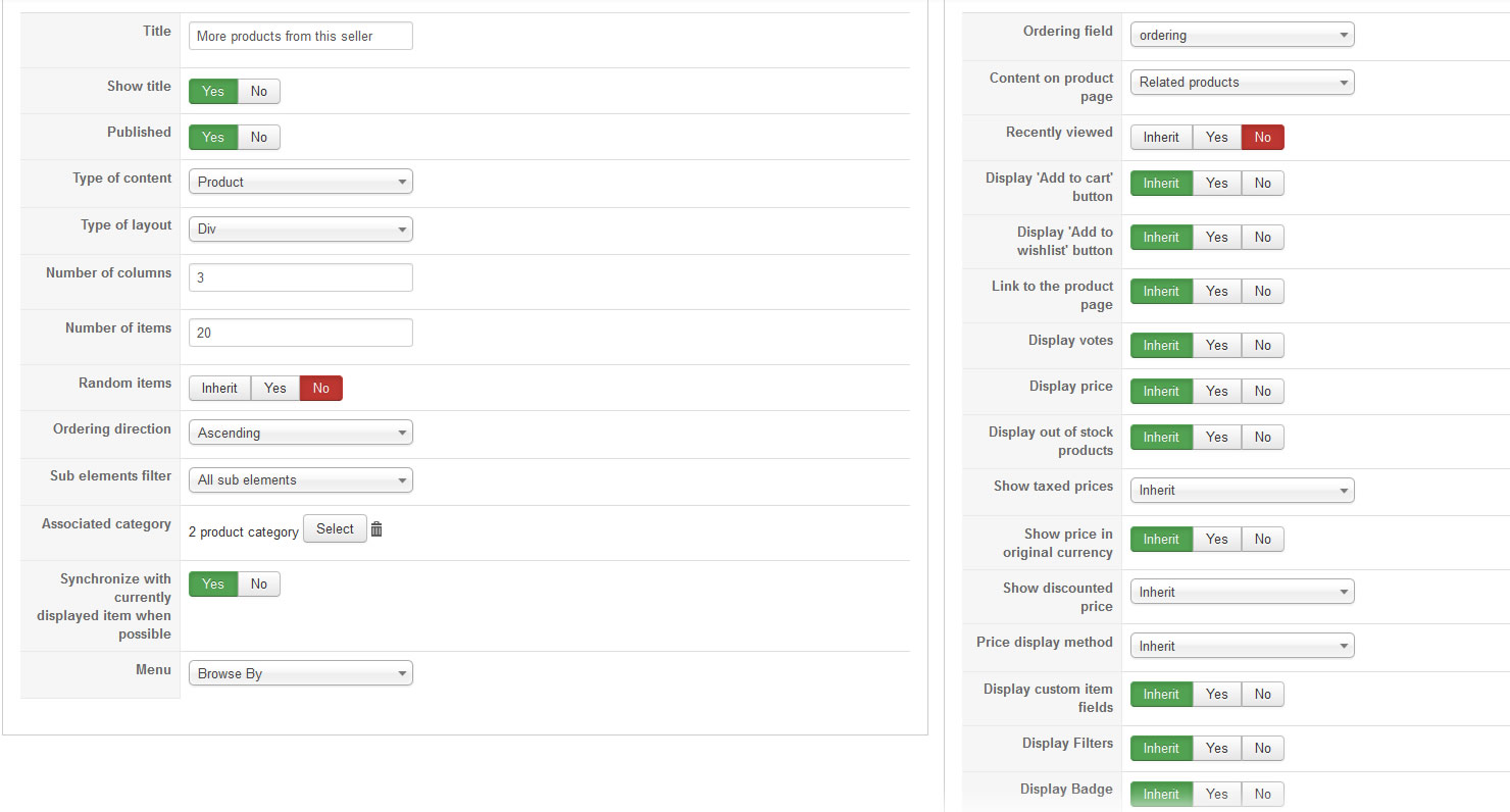

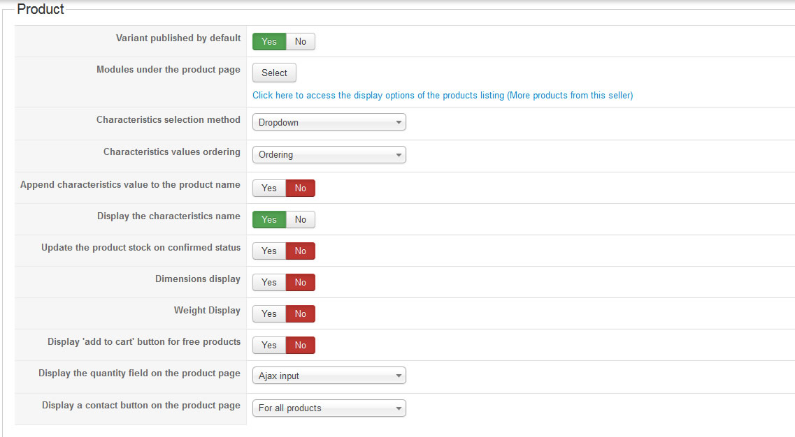

Aha i didnt know you could allocate module in the configuration. It works for hikamarket, but not hikashop under product even though i select the same module to be displayed under product as under vendor page. Should i raise a ticket in hikashop for not displaying the module below the products?
Also the pagination is not showing for the module on this page even though i have the random set to off as described in the FAQ on this page
