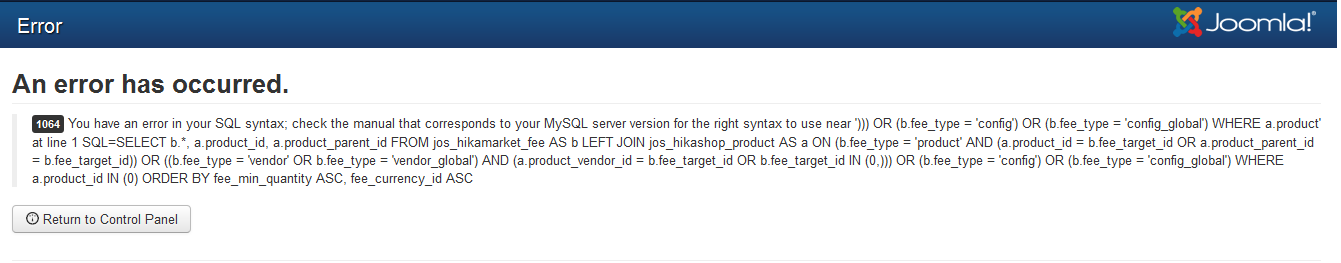

12 years 2 months ago #160011
Thanks, I just saw the demo. Also, I have attached the error I am having regarding to paying commission to the vendor.
  • Posts: 26381
12 years 2 months ago #160059
The fix is here :
www.hikashop.com/forum/22-market-bug-rep...-payment.html#159634
We are working on a new HikaMarket build (1.4.2) with some improvements and latest fixes.
