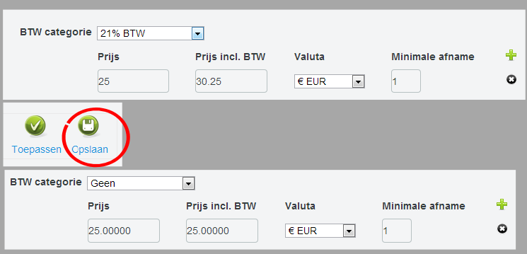

I have a problem and read almmost all articles on the forums. As far as I know i did all i could. But still having a problem.
When a vendor adds an article in the front end, it all goes fine. He enters the Tax 21% and the prices are shown correct.
But when the vendor saves the article, the tax goes automaticly back to default "none" again.
I can change the product in the backend. that works fine. But anyone has an idea if I am missing something?

Please edit the file "administrator/components/com_hikamarket/classes/product.php" and replace the line
		unset($product->product_tax_id);
By
		if(!hikamarket::acl('product_edit_tax'))
It will be fix in the next package (1.4.2).
Thanks for the report and sorry for the inconvenient.

11 years 11 months ago #162158
Jerome you are the best! It all works now!
Thank you so much for the best service ever!
