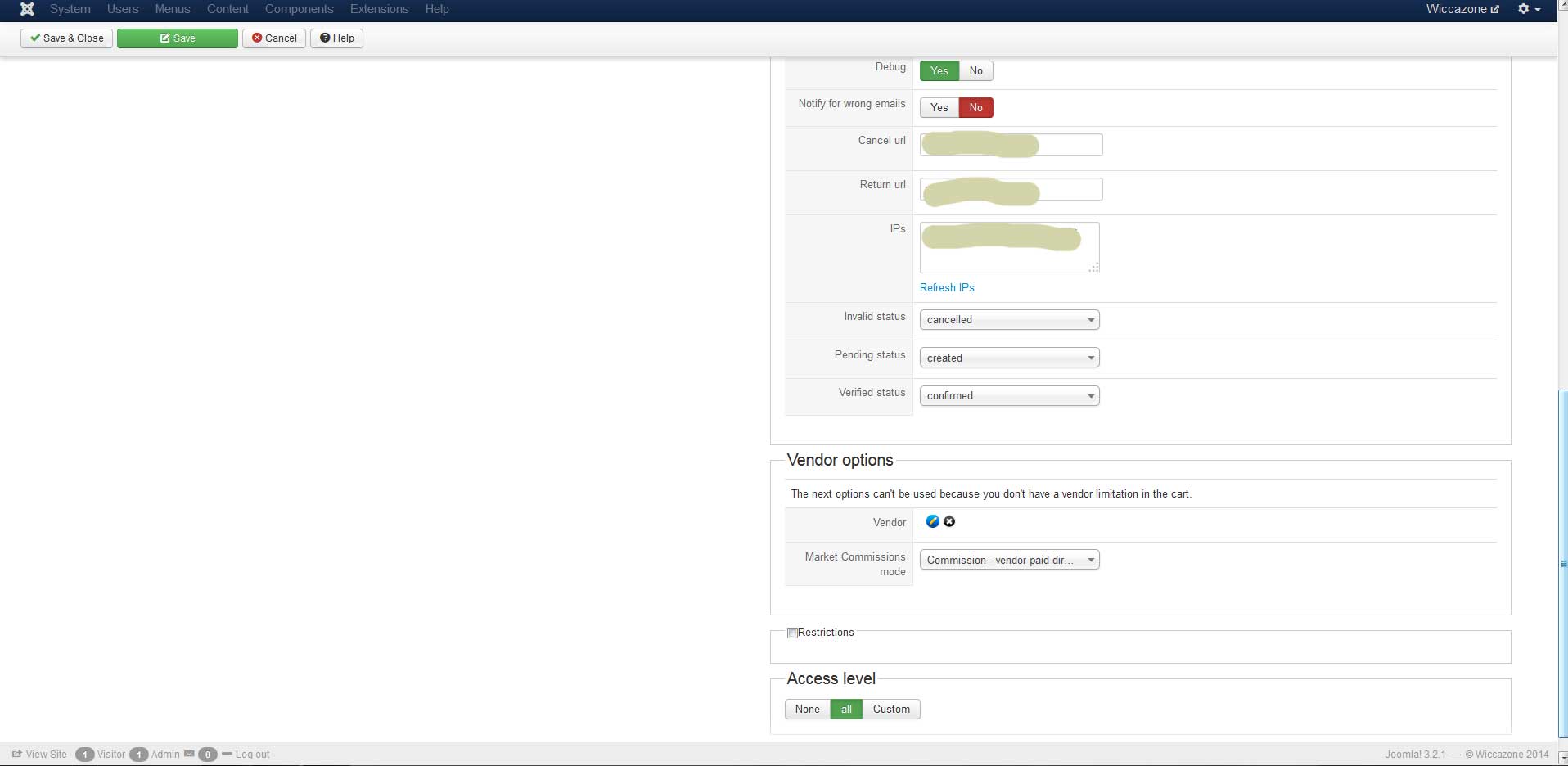

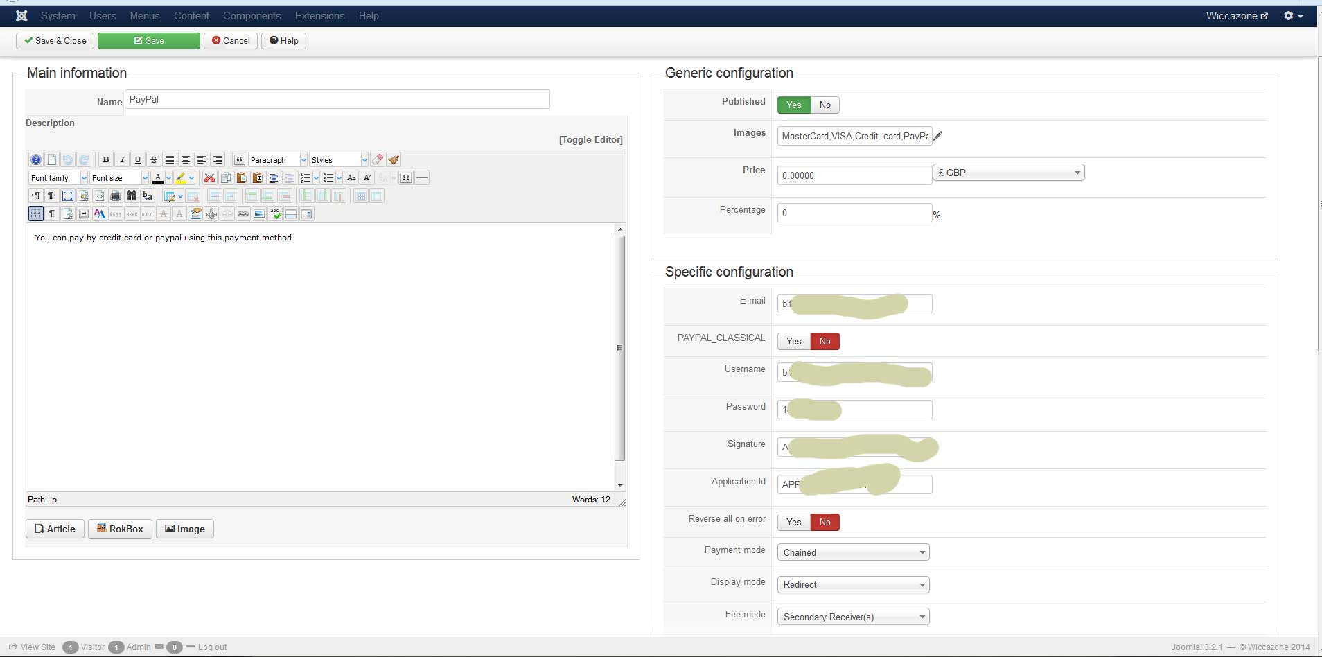

I have tried in debug mode and still get the same error.
Here are a couple of screen shots...it is probably something I am doing wrong - as I am still trying figure out hikashop and hikamarket
Thanks again for any help

11 years 11 months ago #163291
I guess that your sandbox credentials are not right.
Please check that you don't have an extra space at the end of a field. Or maybe an extra space before your password.
