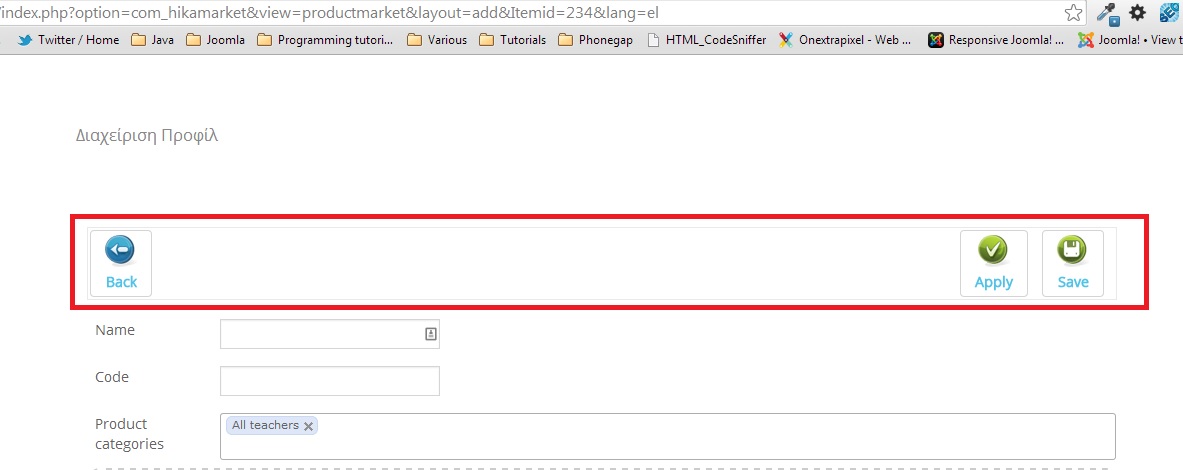

Toolbar when Vendor adds product (from Front End)
  • Posts: 95
11 years 10 months ago #165292
When a vendor adds a product (option=com_hikamarket&view=productmarket&layout=add) we want the toolbar at the top to be at the bottom (we need to find a way to change the position of the toolbar) . I cannot find the code in any view. Any suggestions? Thank you.

The toolbar is displayed directly by the class hikamarketView.
If you want to display the toolbar yourself, you have to use this code
		if(!empty($this->toolbar)) {
			$toolbarHelper = hikamarket::get('helper.toolbar');
			$toolbarHelper->process($this->toolbar);
It is the code used in the hikamarketView (function display).
