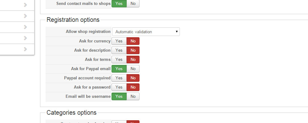

What's your HikaMarket configuration for the vendor registration ?
attached: I have tried it with "Paypal account required" and "ask for a password" on too with the same result
