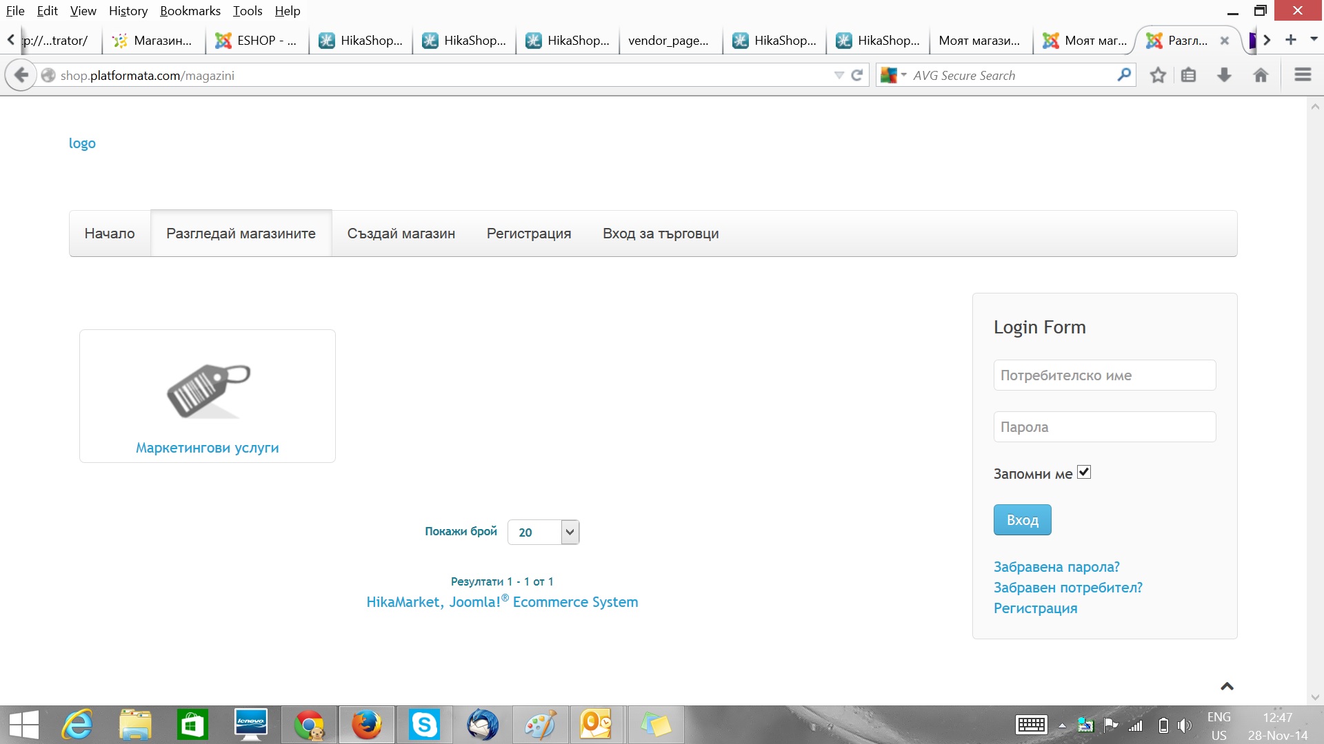

I have the following problem:

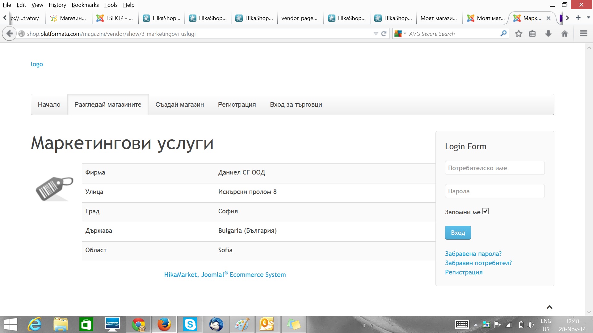

I have set a menu - Browse vendor shops - it works OK and shows a list of my vendors. But when I click on a vendors icon I can see only the vendor`s details (name, address ...) and I want to see the vendor`s products. Obviously I miss something in the configuration, but I have tried everything without success. I would highly appreciate if solve this problem for me!

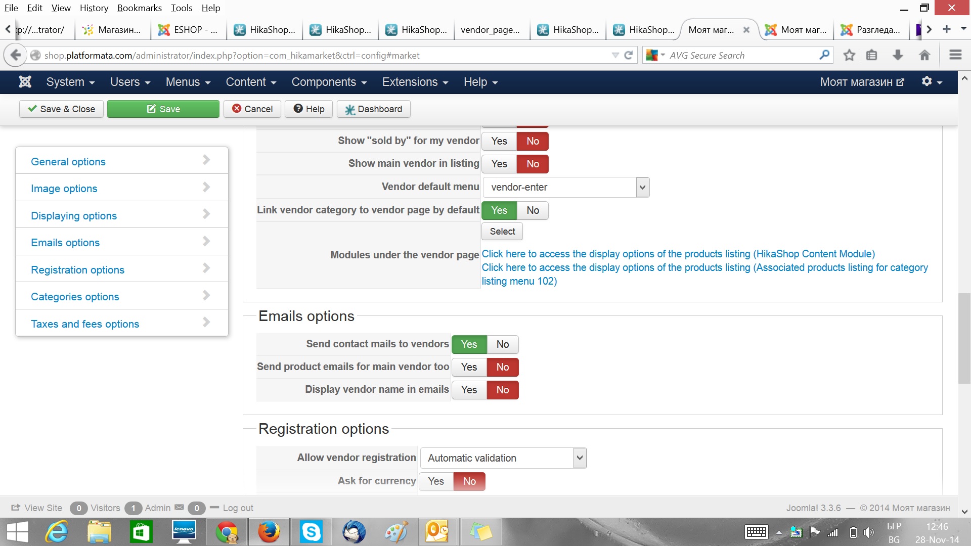

Attached are the front-end printscreens (sorry for the bulgarian) and a prtsc ot the Hikamarket configuration.

You have to check the configuration of the two modules you displayed under the product page.
Be sure that the vendor have some products and check the categories where the products are.
Then, you can modify the product listing module in order to checks the "Associated category" and "Sub elements filter" settings.
You have to select a base category which contains the products and you have to use a filter like "all sub elements" in order to be sure that you will display some products.
Some settings like "recently viewed" can also affect the display of the module.

Thanks a lot! The filter was "inherit". I changed it to "all sub elements" and it works now :)
