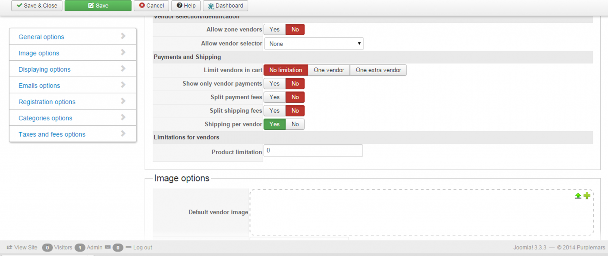

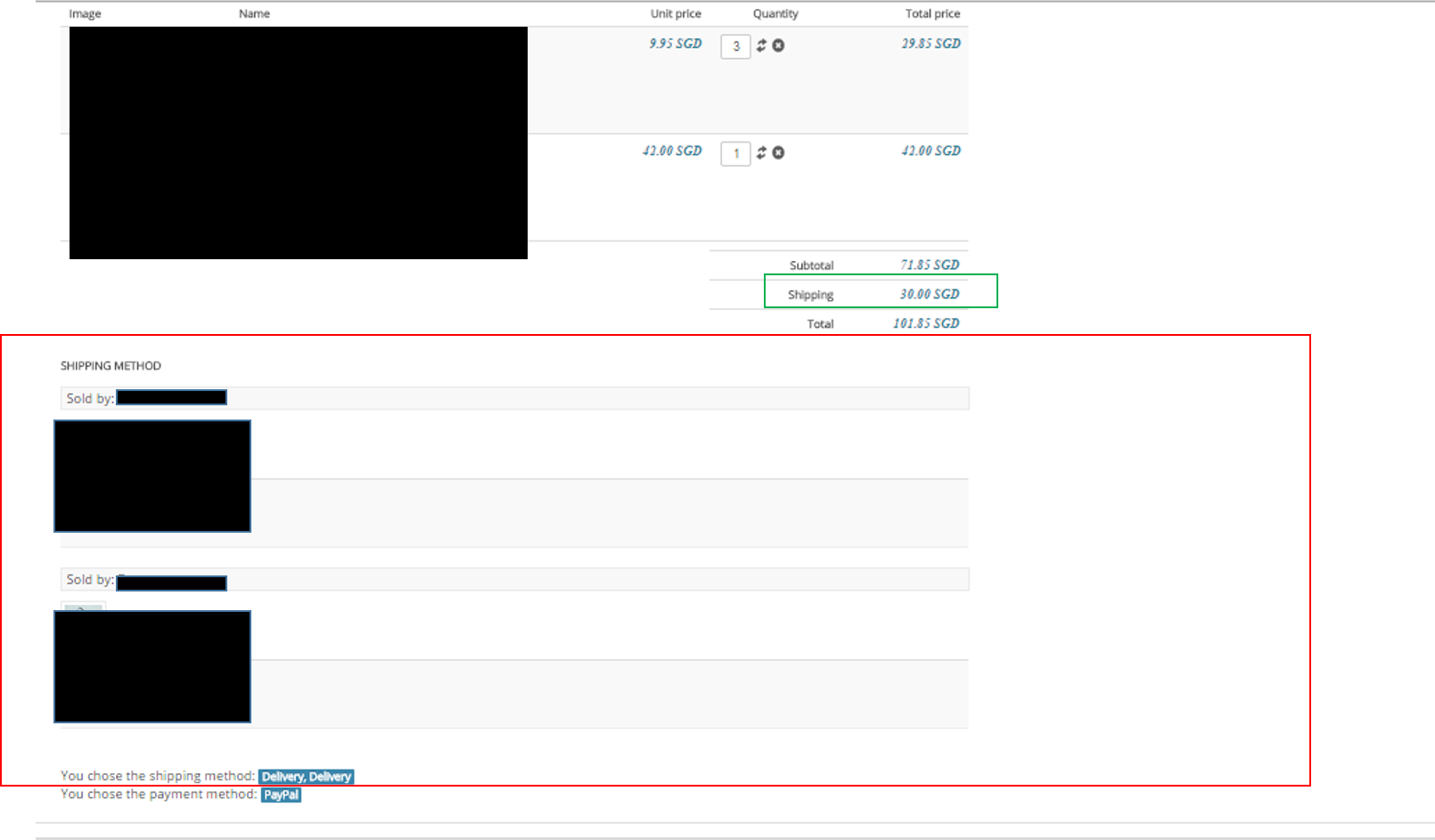

-- HikaMarket version -- : 1.4.4

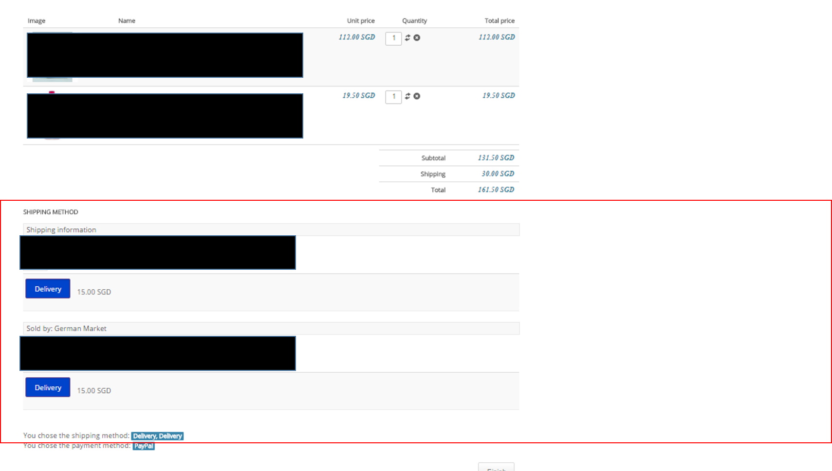

Please see attached image for the current state of my payment page.
I wish to make the following changes:
1. The shipping fee must be applied to the total price and not per vendor
2. Hide the portions in the red box.
Please advise on how this could be achieved.
Cheers!

  • Posts: 43
11 years 8 months ago #183272
Hi Jerome,
Thanks for your reply. I have already disabled shipping per vendor in Hikamarket. I still get the setup as in the earlier screenshot.
Basically, the delivery charge should be a one time charge on the total amount at the time of checkout, regardless of the number of vendors to whom the products in the cart belong to.
Please see attached screenshot. Please advise. Cheers!

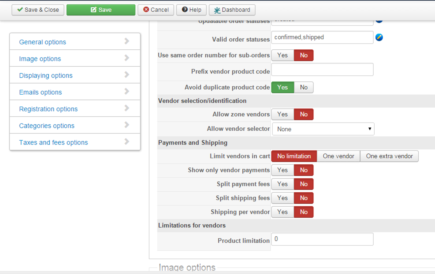

  • Posts: 43
11 years 8 months ago #183443
Hi Jerome,
Sorry if I was not clear.
My current configuration is :
And the outcome i see on the checkout page is :
The end state I want to achieve is :
1. The part in the red box is not shown
2. The shipping fee is a one time fee added to the total due at the payment point, and there should not be a separate shipping fee for each vendor.
I hope this is clearer and please let me know if further clarification is needed.
I have created an account for you. Please see your pm for details
Last edit: 11 years 8 months ago by mentor.

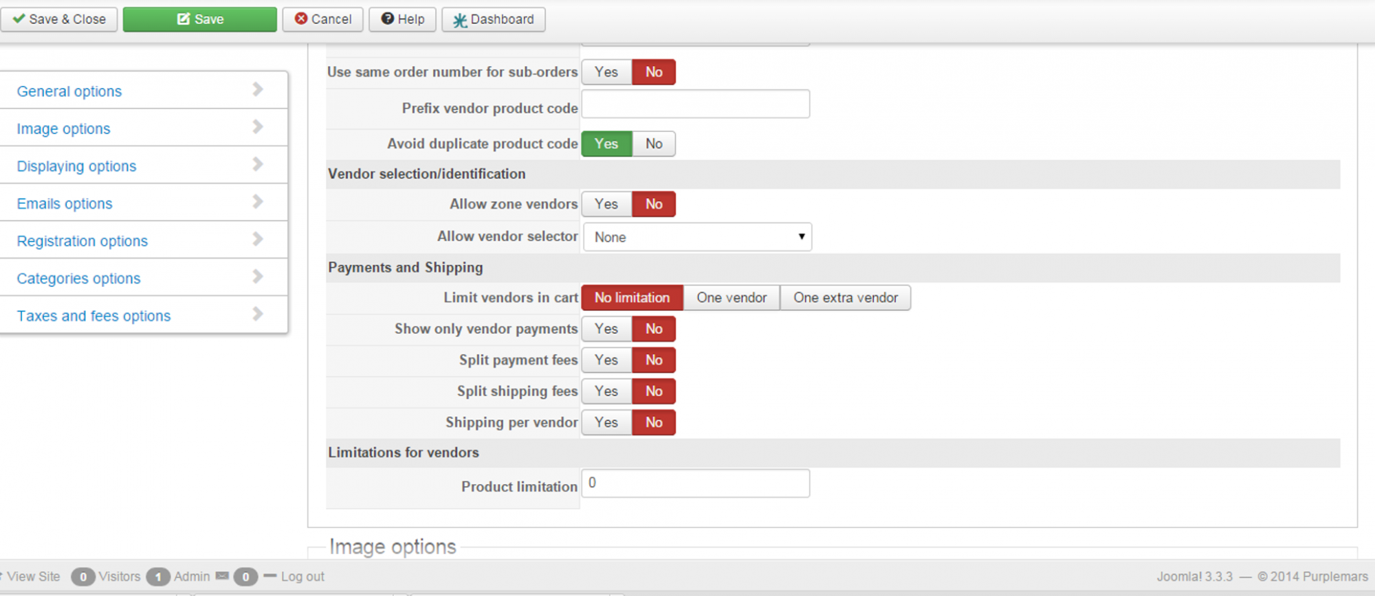

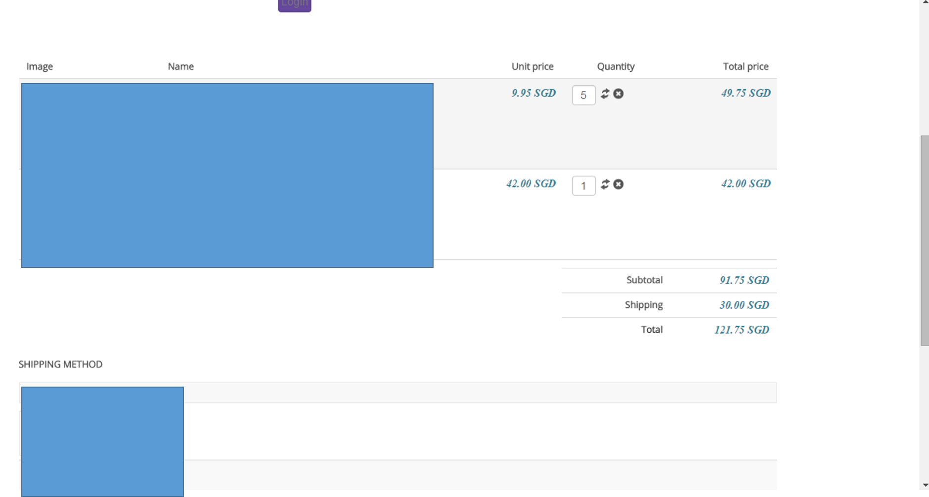

  • Posts: 43
11 years 8 months ago #183519
Hi Jerome,
Sorry I was not clearer in my earlier post.
I had already deactivated it and still got the same results.
Please see screenshots
Cheers!
  • Posts: 26381
11 years 8 months ago #183522
Okay, thanks.
So know the shipping method selection just propose you one "group".
The HikaMarket part is good ; the rest is HikaShop related.
If you want to hide the shipping method selection in the page ; you can use CSS or you can use view override.
By using CSS ; you can hide the entire zone so the customer won't be able to see it.
By using view override (for the HikaShop view "checkout | shipping") you can modify the output html in order to not display the table and to display an "input hidden" instead of the radio.
If you remove the "shipping" from your checkout workflow you won't have any shipping in the order ; in your case you want to keep the shipping but just not display it.
You can read more about HikaShop customization in this documentation page:
CSS is easier than view overrides ; so for the moment it will be the method I'll recommend you.
  • Posts: 43
11 years 8 months ago #183536
Hi Jerome,
Thank you.
Could you clarify what you meant by:
I have managed to hide the table that shows the delivery for each vendor.
However, I can't seem to find the class that I need to hide to get rid of the following messages:
You chose the shipping method: Delivery, Delivery
You chose the payment method: PayPal
Also, the cart still charges shipping for each vendor. Meaning, if there are 2 vendors, the cart charges $30. I want it to charge only $15 regardless of the number of vendors whose products are in the cart

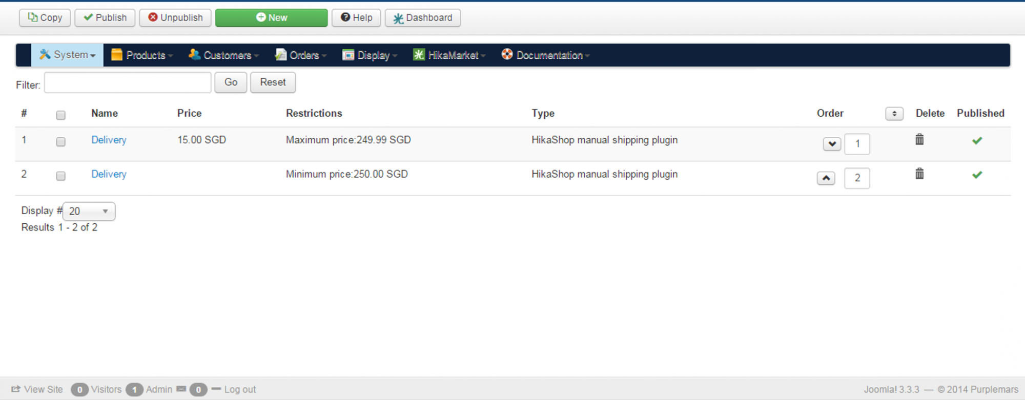

  • Posts: 26381
11 years 8 months ago #183934
I take a look at your website.
Unless you're using warehouses ; I really don't understand how you can still have
And I saw that you're using warehouses in HikaShop ; you got one warehouse called "Deuter" and some products are assigned to that warehouse.
So the display you got is logically regarding your configuration.
It does not come from HikaMarket anymore ; you do not have "sold by ...." shipping groups anymore ; you just have two warehouses (the warehouse "Deuter" and the "no warehouse").
The following user(s) said Thank You: mentor
  • Posts: 43
11 years 8 months ago #184017
Hi Jerome,
Thanks for the guidance, I had confused Hikashops warehouse with our warehouse.
I have removed that and it works now
Cheers!
