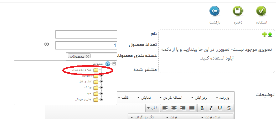

My previous issue solved.
I have another issue with category selection and related product selection in "add product" page in vendor front-edition. When I select a category, its products and subcategories do not load. (As the attachement)
Thanks in advance.

  • Posts: 26381
11 years 3 weeks ago #208841
When there is subcategories or products under a category, you can see some kind of "+" near the category icon.
If there is no symbol, it means that the category is empty.
In your example, the category is empty, there is no subcategory (or no product if it's a product selection).

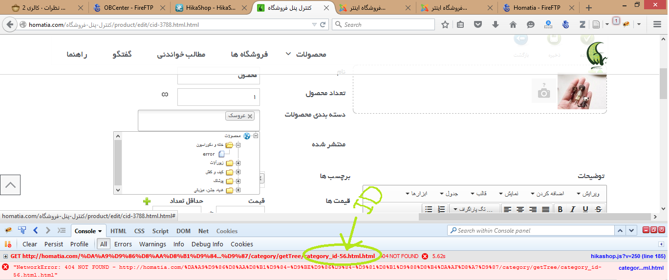

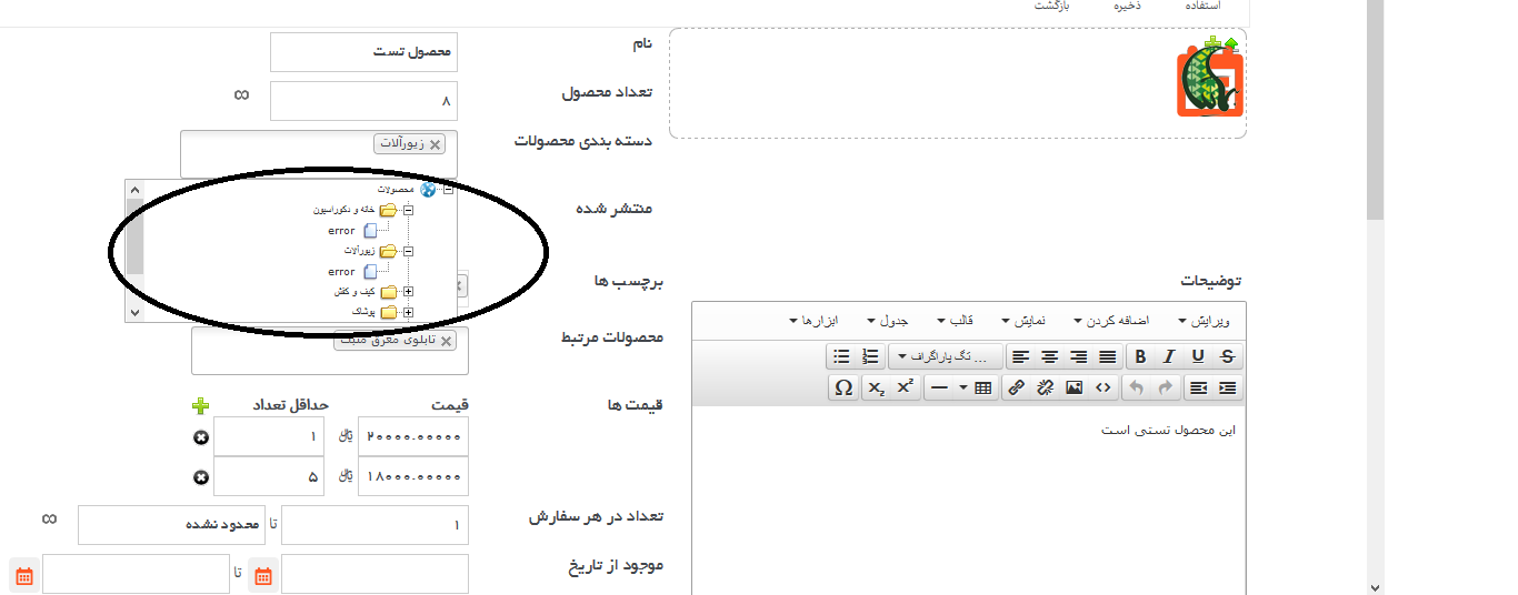

  • Posts: 54
11 years 3 weeks ago #209160
I removed {} but problem occurs in different way. See the attachment.
  • Posts: 26381
11 years 3 weeks ago #209177
Where do you remove the brackets ?
If you look at the network log, you can see the "XHR" calls (ajax calls) and see the URL which is used.
And you can also see the returned content. Knowing the used URL will help to understand the current issue.
If you do not know how to do it ; an access to your front-end will be required.

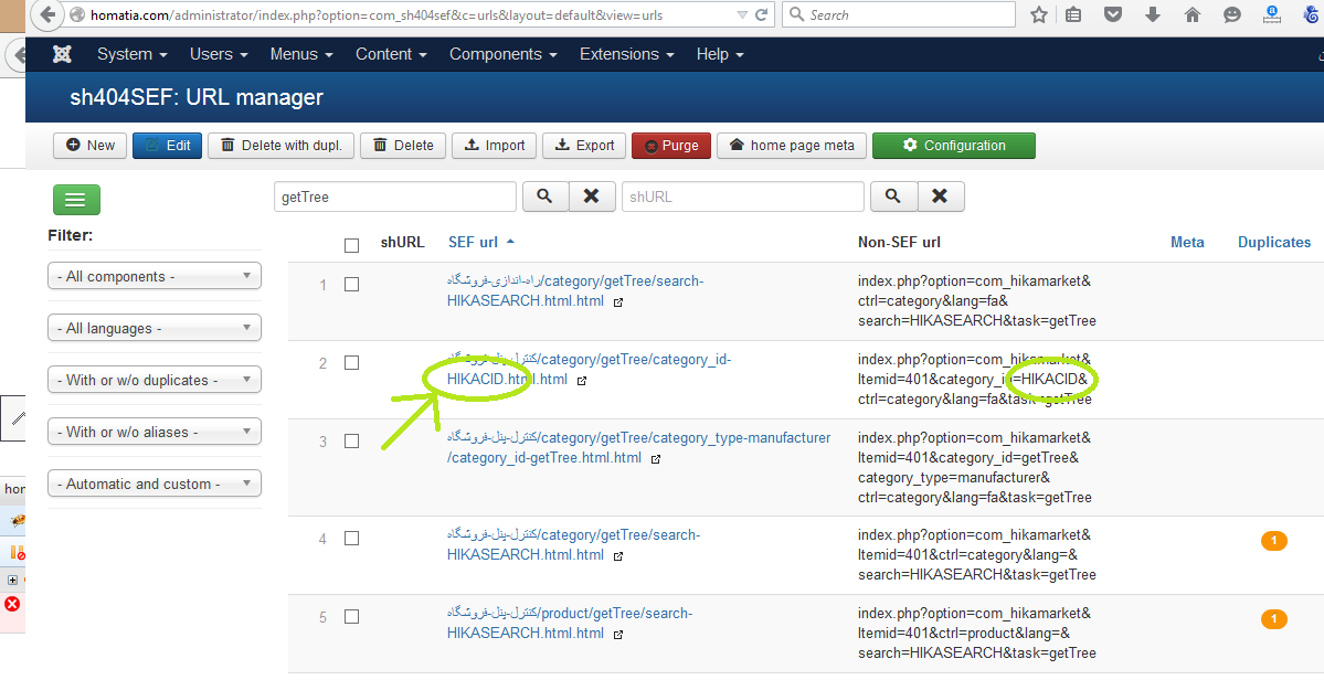

  • Posts: 54
10 years 11 months ago #212300
Thanks for your response.
It seems it doesn't work. HIKACID does not replace by any value in the Sh404SEF (see the attachment), while it does in the hikamarket requests. (see again the attachment).
