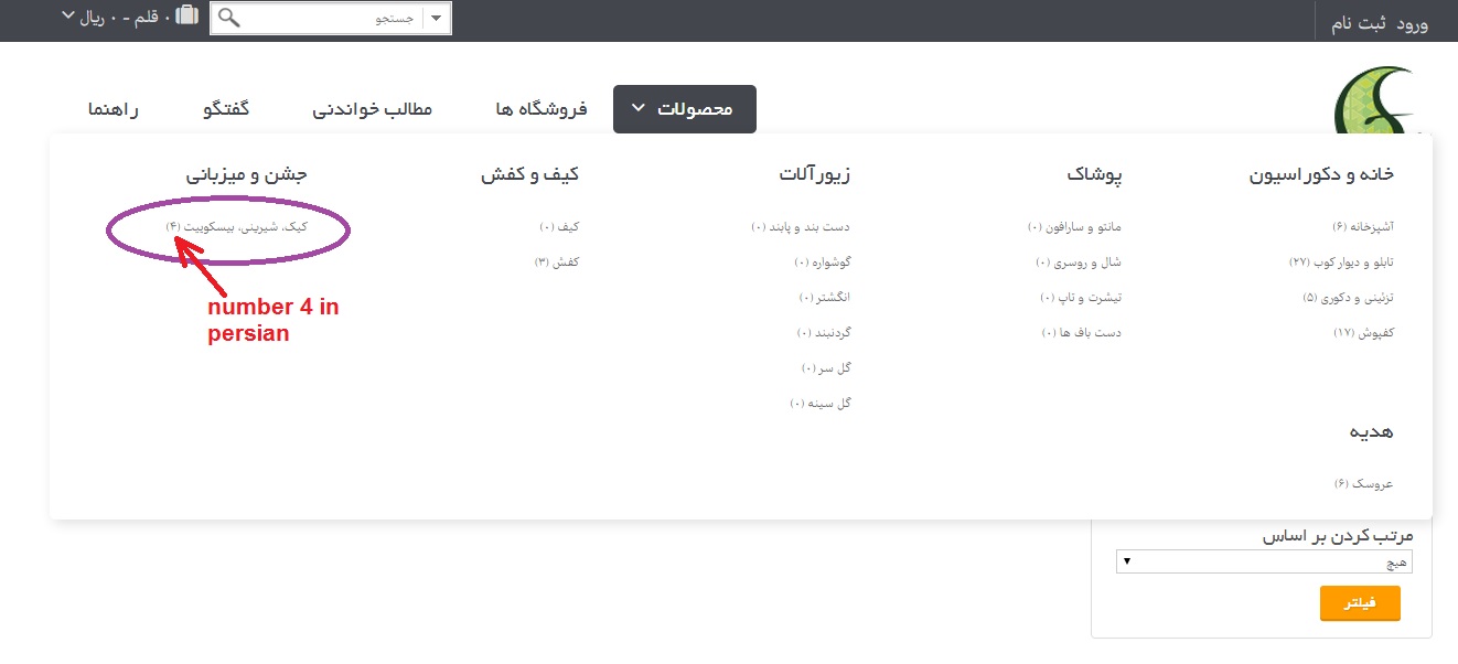

  • Posts: 54
10 years 10 months ago #211337
You were right, I forgot to save the setting after selecting modules for vendor page.
Issue:
When vendors add product and publish them, they are not shown in product listing modules. Not in vendor page, not in product or category listing page.
For example this vendor added and published four products:
http://homatia.com/%D9%81%D8%B1%D9%88%D8%B4%DA%AF%D8%A7%D9%87-%D9%87%D8%A7/vendor/show/12-.html.html
(as you see, its products are not shown in product listing module assigned to vendor page)
Besides, these four products are not shown in product listing page:
http://homatia.com/%D9%85%D8%AD%D8%B5%D9%88%D9%84%D8%A7%D8%AA/%D8%AF%D8%B3%D8%AA%D9%87/92-.html.html
If you see in the image attached, four products are recognized by hikashop module but they are not shown in product listing module.
