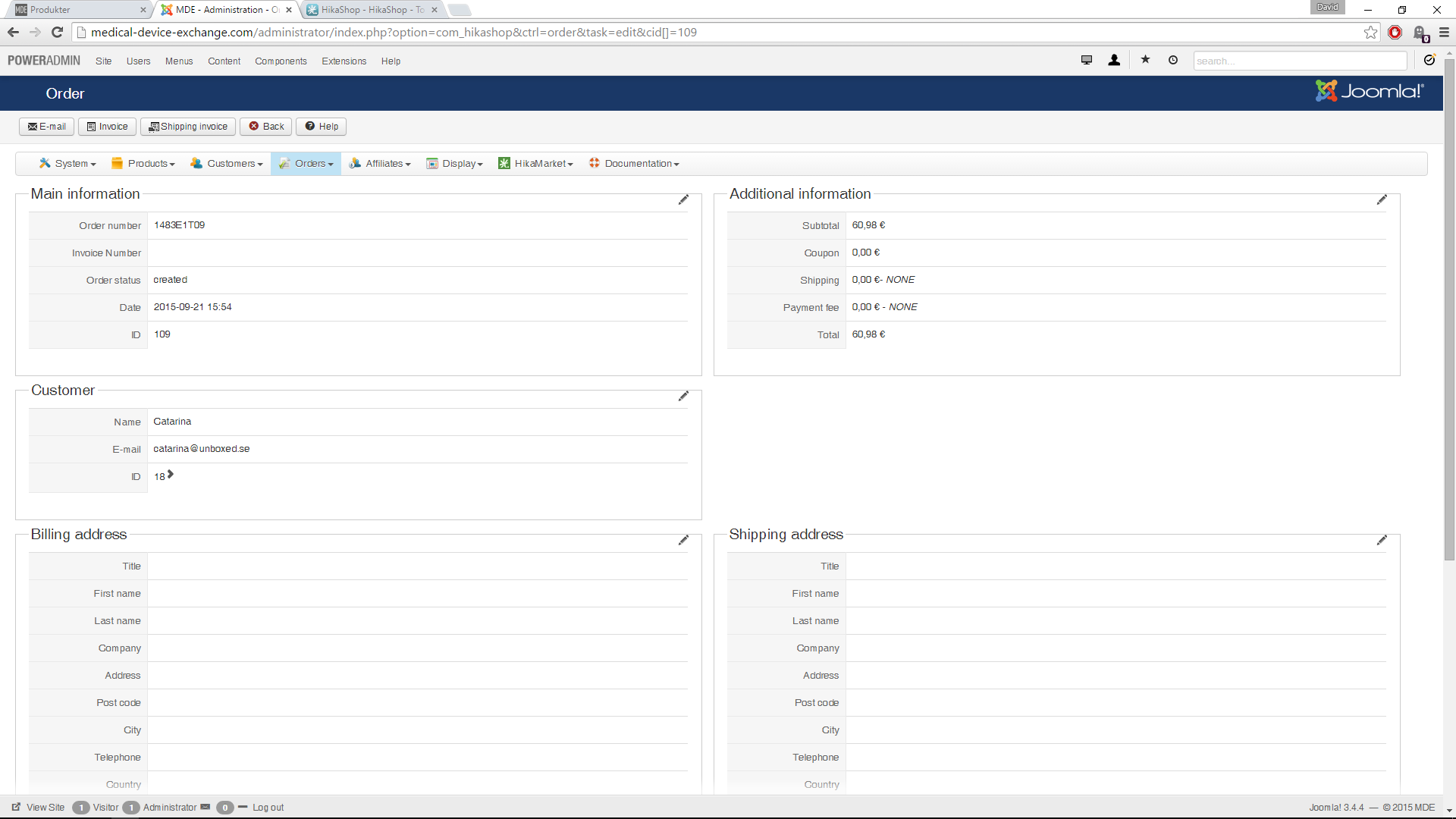

2) For the address - no address is added in the process at all (see screenshot). And I'm looking for the vendor address according to the vendor setting and not the administrator default address. To generate the address, I have to click customer, reselect the same customer, and and set 'Set user addresses' to 'Yes'.

With the current setup, vendor address and vendor administrator address are the same (as I can see in the vendor page and the user page).
The issue is that neither address is added as you can see in the previous screenshot. So, the choice is either adding the vendor address manually in the Billing Address fields or re-selecting the customer and setting Set User Address to yes.
