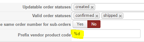

I have 3 questions of configuring hikamarket:
1. I set the prefix vendor product id to %d (see the attached file), but when I created product from the front end, the product code didn't change.

  • Posts: 26382
10 years 2 months ago #241250
1 - Please be sure that you are creating a product with a vendor and not with your main vendor.
The usage of "%d" is to place the vendor in a very particular place in the string, like
store%d_product-
Otherwise it will use the prefix and put the vendor ID (and an underscore) just after it.
If the product code already start with the generated prefix ; HikaMarket won't use it (because the prefix already been set before).

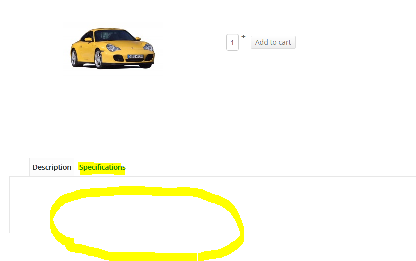

  • Posts: 252
10 years 2 months ago #241256
Thanks for the quick response, it was very helpful.
As per the issue 3,4 above, please see the attach screenshot.
3. When the product does not have the spec inputted, can I set the tab just don't show.
4. I want to put an additional tab, and the content of the tab is from the content module, is that possible?
BR

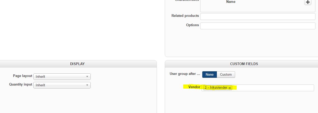

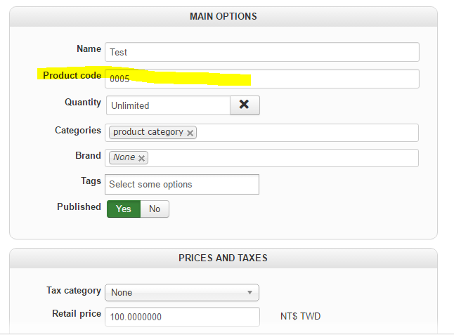

  • Posts: 252
10 years 2 months ago #241258
For issue 1, I used demo(which is the demo data fro installation) to login.
I set the use "demo" to be "hikaVendor"
and then, I create a vendor product from the front end,
The result from the back end is like the screenshot,
The product code is still 0005 (the same as I input, no prefix)
but down the same page in the custom fields, I did see the product belongs to the user group "hikaVendor"
Did I missed anything ?
Best Regards
  • Posts: 26382
10 years 2 months ago #241278
3 & 4 - Your question is related to the HikaShop product page and not to HikaMarket.
Please create a new thread in the HikaShop forum section for these points.
1 - I don't know what you did but I cannot reproduce your issue in the demo website using the "demo" account of the vendor with ID "6".
Config : pasteboard.co/1emIbY88.png
Product just after "apply" creation : pasteboard.co/1emIZig1.png
