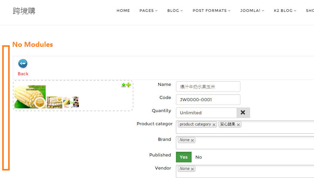

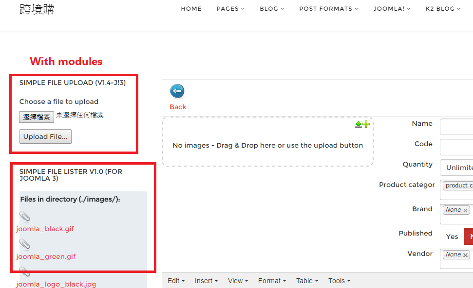

I need to put some modules to the left of product detail page, like
www.ccfia.org.tw/xmass/index.php/2016-06...01-38-56/add-product
(Menu: Main menu\hikaMarket\Add ptoduct)
but the way vendors can access this page is by
www.ccfia.org.tw/xmass/index.php/2016-06...1-38-56/product-list
(Menu: Main menu\hikaMarket\Products list)
My question is, when I access the page from menu, I can see the correct layout that two additional modules set to the right of it, but from the products list, the modules don't show.
What should I do to show the right product detail layout from the products list?
Best Regards
Scott
PS, You can log in as a vendor by demo/12345
  • Posts: 26382
10 years 2 months ago #242222
You need to configure your modules in order to be displayed on the Joomla menu you want to.
There is nothing to do in HikaMarket (or in HikaShop) for that ; it's fully related to Joomla and the module/menu system.
If you want more flexibility with your module configuration ; you can use the extension "advanced module manager".
Because, even if we added new filters in some HikaShop module ; these filters are only for HikaShop modules and just related with the HikaShop pages. So it couldn't work for external modules like your "simple file upload/list"
