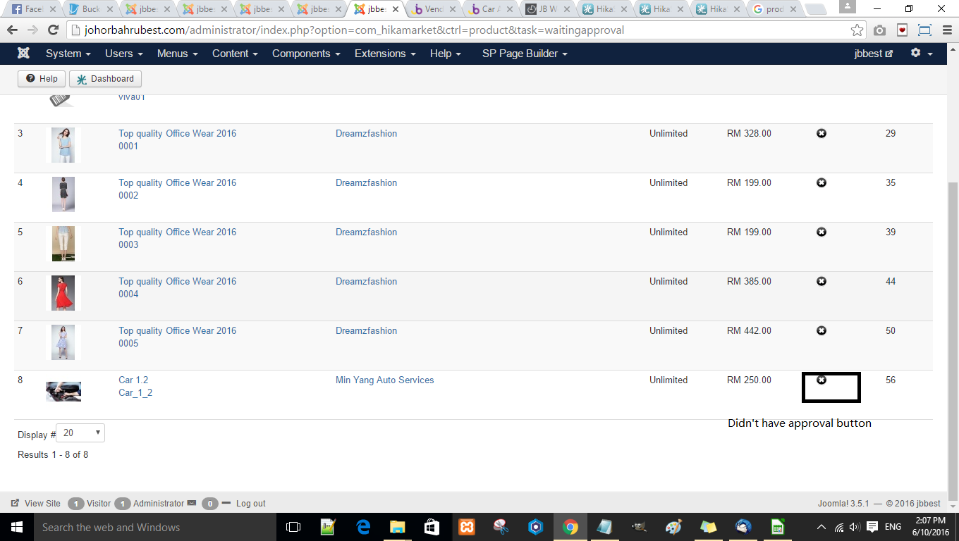

Hi Support,
Question 1
The approval button didn't show at backend listing

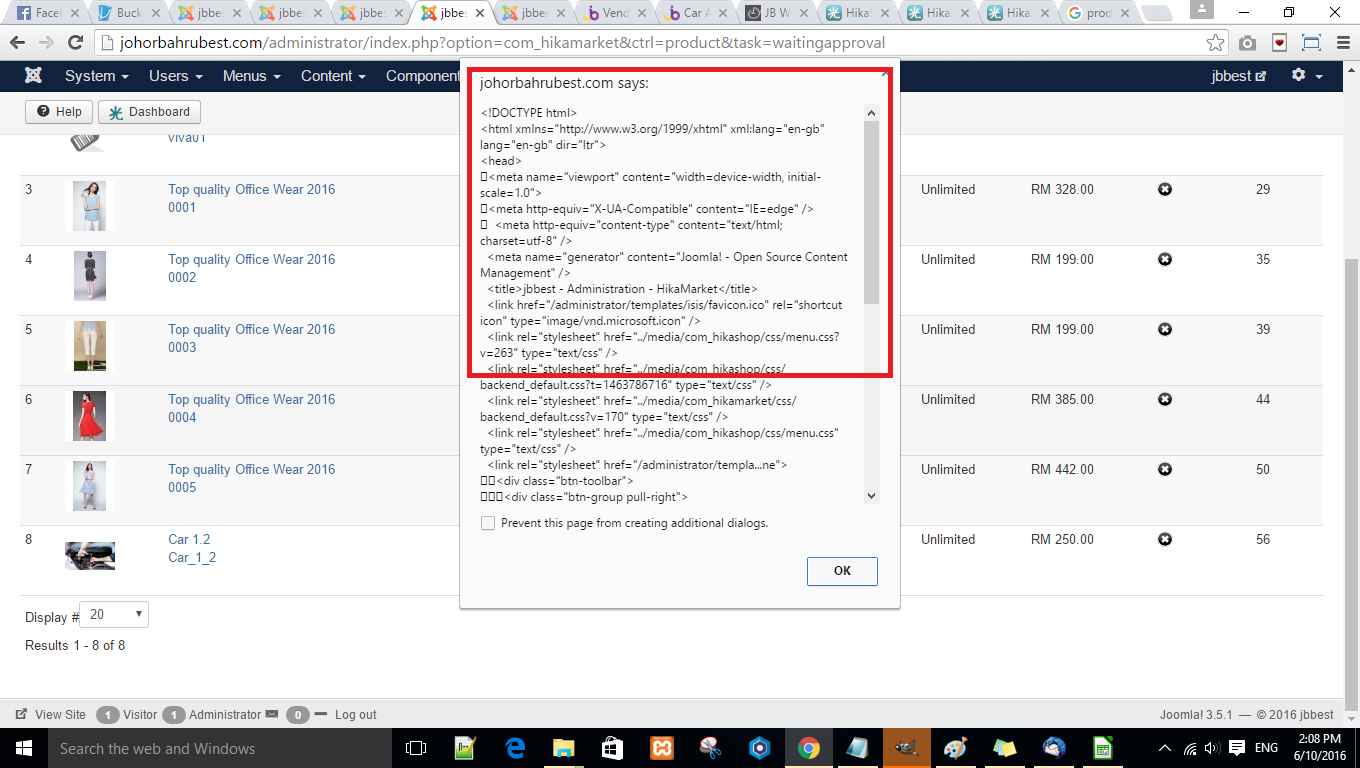

Question 2
When click delete button, it will display error message
Thank you.

Thanks for the report on the "delete" issue.
To approve a product in the backend, you have to click on the product (to see his content) and perform a "save".

1. Is there a way to approve multiple product at one click? it is quite not possible to approve 100+ product by one by one click into
2. We also found the "approve" button after click into detail, is it the "save" button you mean above?
  • Posts: 26382
10 years 2 months ago #242950
2 - My mistake ; yes I was talking about the "Approve" button.
1 - I added a feature request in the HikaMarket project.
For the moment, you could use some mass action if you want to change the "product_type" of a bunch of products from "waiting_approval" to "main".
