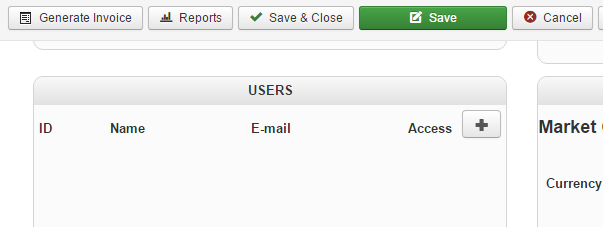

When we add a user to a vendor account it is being removed when we save the Vendor record.
Which table does the record get written to? What checks does it make?
How can I figure why the user isn't being saved on the Vendor account?
before.PNG = user before pressing SAVE.
after.PNG = user after pressing SAVE.
Thx, Darrell

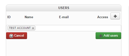

When you add a user to a vendor, you need to use the green button "add users" that we can see in your first screenshot.
The "save". It will add the line in the interface and the "save" will confirm the addition.
Before you do not provide the screenshot with the user in the "table" we could thought that you miss to click on that button before the save.
