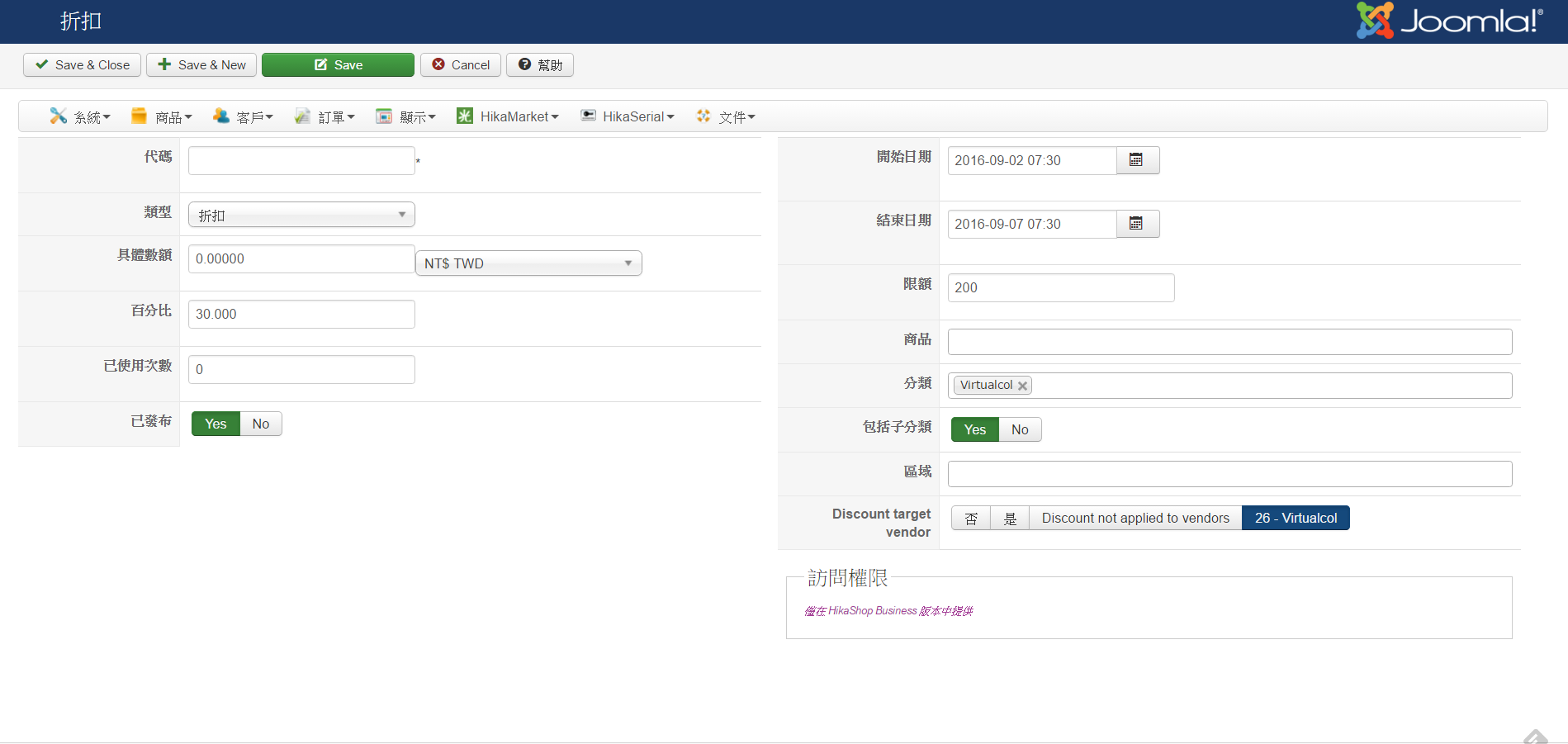

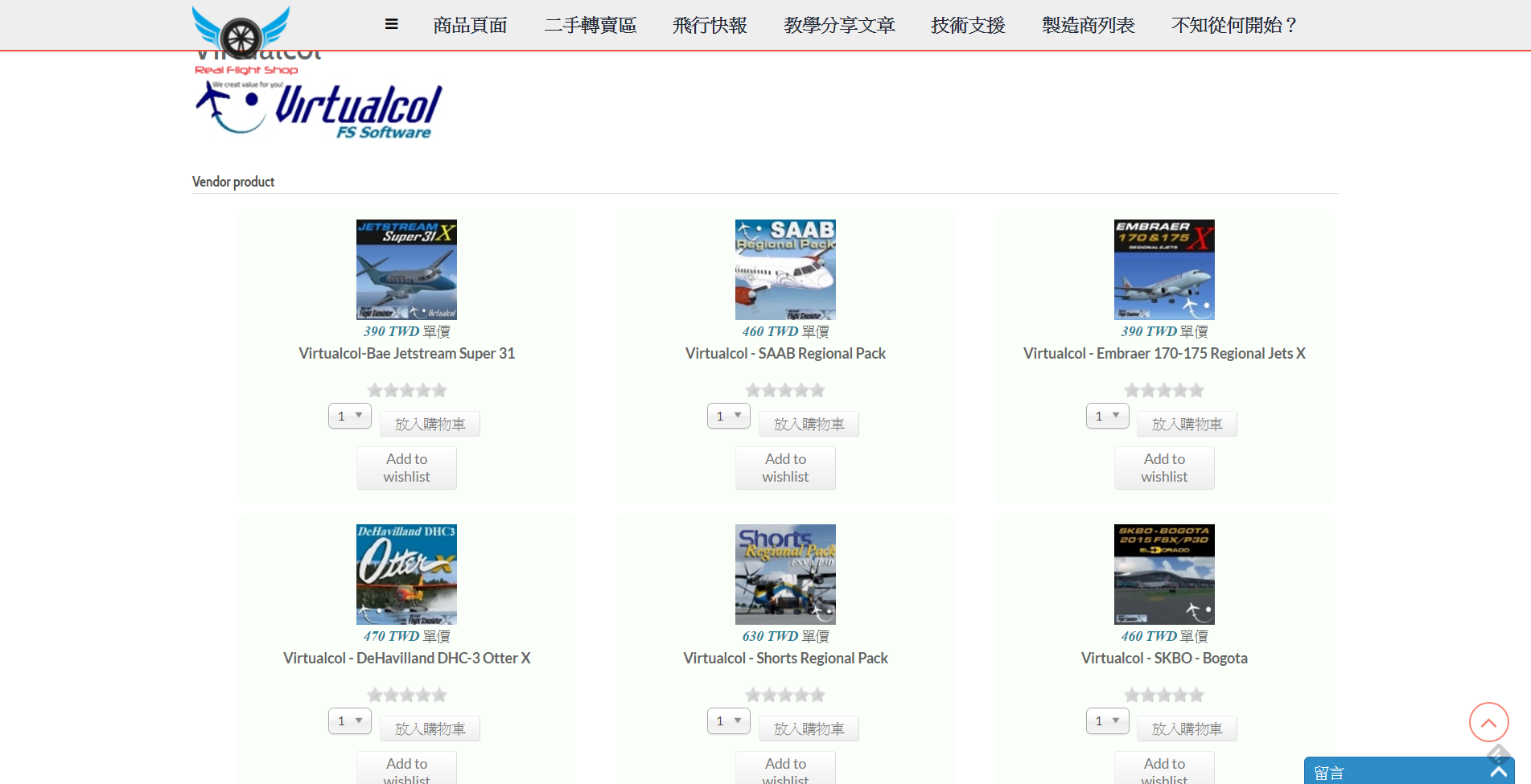

I have set a discount for specific vendor as attachment show, but as I went to my front end site, the vendor discount I set won;t apply, it just show the original price but not the discount percentage price.
Is there anything I missed.
Thanks!

I see that you're using a restriction on a category and also a restriction on the vendor.
Are you sure that the other restriction are right set-up ?
Like, if you remove the "discount target vendor" restriction ; does the discount visible on the products ?
