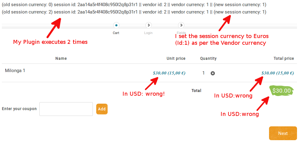

My test case is as follows:
Hikashop main currency: USD (currency id:2)
The product "Milonga 1" set up in Euros (currency id:1) and owned by Vendor with vendor ID = 2
Vendor with vendor ID = 2 has currency in Euros (currency id:1)
Then when I add the product "Milonga 1" to the cart and I'm redirected to the checkout I see as per the attachment.
As you can see the plugin executes two times.
At the begining of the plugin the session currency has no value or value 2 (USD), and at the end of the plugin I set it to the Vendor currency Euros (id:1).
But the display of pricing is still showing as if USD is the cart currency, including the total. So something looks like it is not working.
Any idea? Am I setting the right currency session setting? Is there anything else that could be changing the session currency back to the main shop currency after my plugin?
Last edit: 9 years 8 months ago by Jerome. Reason: Modifications in the code
  • Posts: 26381
9 years 8 months ago #256135
I made some modifications in your code.
To change the currency, the best is to change the HikaShop currency so the all website will use it.
Each time a plugin (or any code) require the currency, it uses the "hikashop_getCurrency()" function.
  • Posts: 128
9 years 8 months ago #256333
I tested your modifications and it is working great.
Thanks a lot for your help, much appreciated!

Well now both are published:
Vendor > Edit > Currency is published
Product > Edit > Price > Currency is published.
The best would be to publish only the first one, and to process in the code, product currency = vendor currency.
This way again, all products currency = vendor currency.
Please let me know, I'm pretty sure your code is almost the solution.
