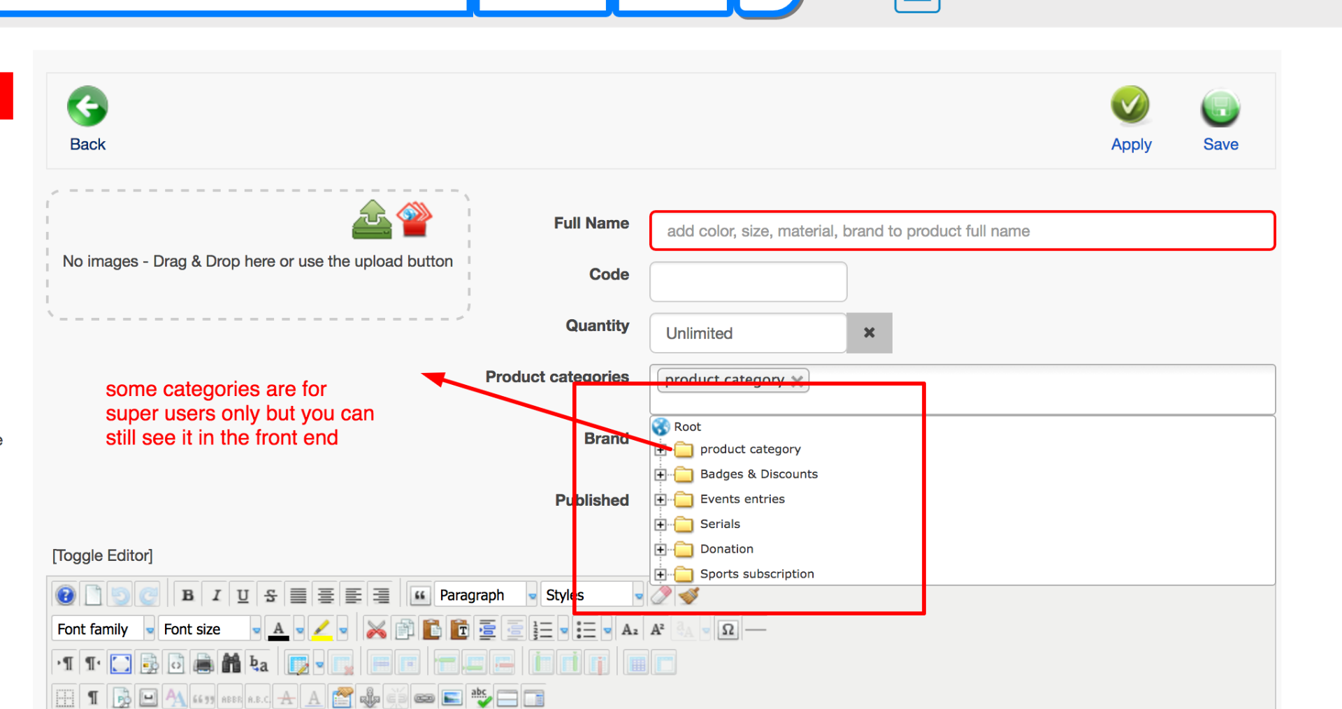

my next issue is the category setting. i created categories and set the the user access to super administrator. unfortunately its still appearing in the front end for registered members.
how do i fix this?

  • Posts: 26382
9 years 7 months ago #258859
You're talking about the HikaMarket category listing or the HIkaShop category listing ?
  • Posts: 490
9 years 7 months ago #258928
hi
this is the menu link Vendor product add.
please see photo
  • Posts: 26382
9 years 7 months ago #258930
