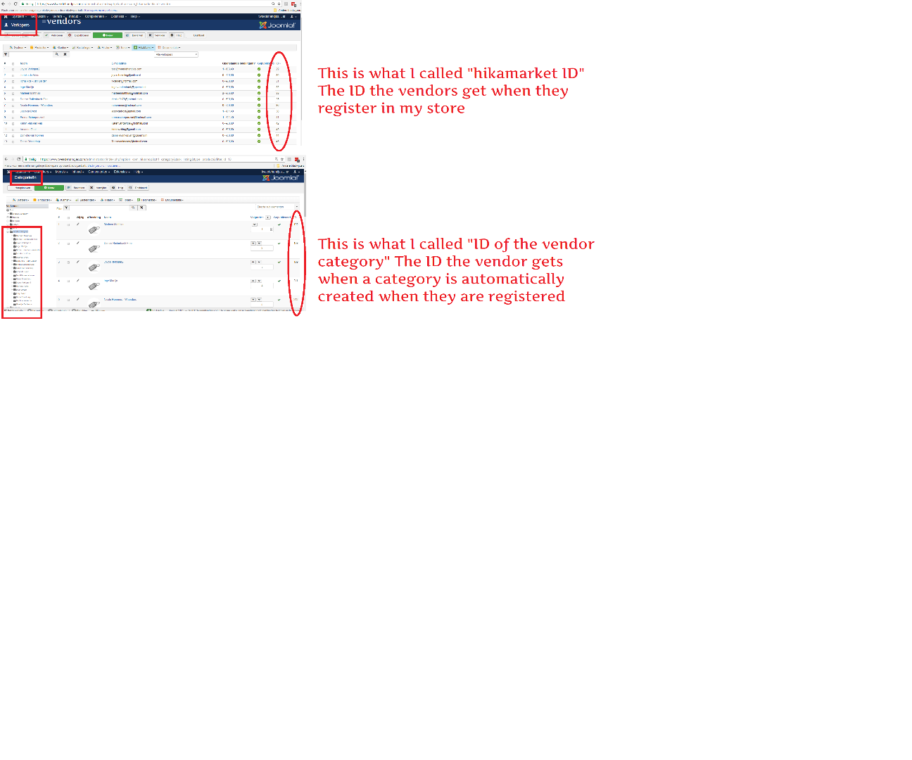

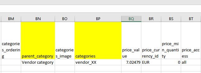

  • Posts: 115
8 years 9 months ago #281901
Hello Jerome,
I have attached more detail about what I call "Hikamarket ID" versus "vendor category ID"
Hikamarket ID is (for me) the ID the vendor gets assigned when he/she registeres in my store.
Vendor categegory ID is the ID he/she gets assigned when a vendor category is automatically created in Hikashop (I have this configured).
Which one do I use??
Furthermore I have attached a part of the uploadsheet. When I put the information like I did here, the upload information is not flowing into the Vendor category, but the system is creating a new category under "product category". But I don't want it to flow there, I want it to flow in the already existing Vendor category. Could you see what I do wrong?
Hopefully I am more clear now and you are able to help me.
Kind regards,
Joyce
Last edit: 8 years 9 months ago by joycehoveling.
  • Posts: 26381
8 years 9 months ago #281912
  • Posts: 115
8 years 9 months ago #281960
Hi Jerome,
Ok now I know which vendor ID to use, but can you also tell me how to put it in the uploadsheet?
I just cannot figure it out, so sorry.
Thanks!
Joyce

  • Posts: 26381
8 years 9 months ago #281990
The categories have a category_namekey field, right ?
The screenshots you gave do not explain what you're trying to import and I can't even tell you what is wrong with your content.
For sure what you have entered for the two highlighted cells is not correct since it's not what I told you to do.
I think you should start to have a working CSV to import categories and then you will be able to apply the modification that I'm telling you to do since my very first message.
To create a vendor category, just import a category with the namekey "vendor_XX" where XX is the ID of the vendor.
Please note that category namekey is unique. So you can't have two categories with the same key.
Afterwards, if you have issues with the import of categories in HikaShop ; please open a thread in the HikaShop section of the forum.
For what's related to HikaMarket and how a category is considered as a "vendor categories" ; it's what I told you.
