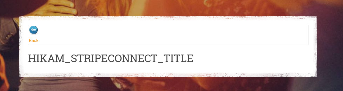

Now the Vendor sees the Stripe button in the front end, but when clicking the Stripe Button the following error shows:
Fatal error: Class 'hikaInput' not found in ............/plugins/hikamarket/stripeconnect/stripeconnect_ctrl.php on line 40

But there is NOTHING happening after clicking the Stripe Button in the Vendor Control Panel (front-end). There is no process starting to connect/authorise the Vednor's Stripe Account, I only see the attached which does nothing.
Please explain what should happen once a Vendor clicks the Stripe button in the HikaMarket front end.
Thanks!

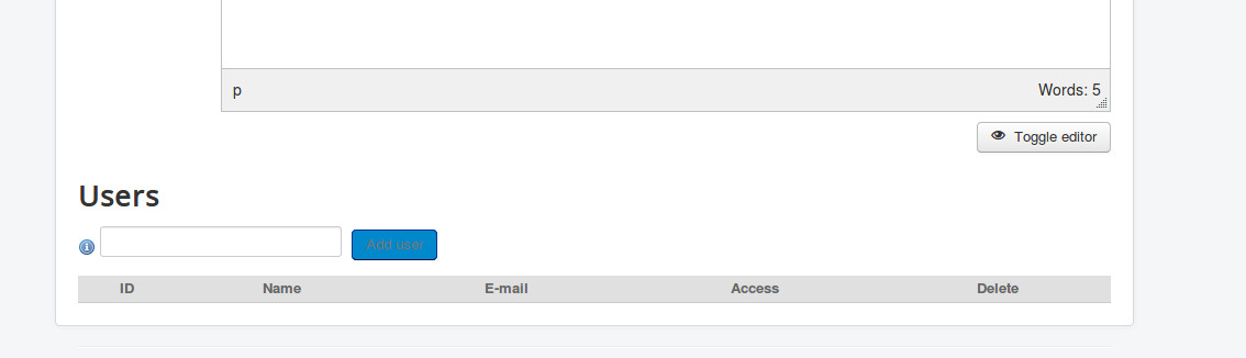

However I don't get the "Connect with Stripe" button you showed me in the Vendor Account page (see attached)....I removed the template overrides for that view and then changed to Protostar template but still I don't see it...I also enabled all the Vendor ACL permits in HIkamarket Config
How is that button being inserted there? Via a plugin trigger? Maybe I can add that trigger to the view....
I'm using HikaMarket 1.7.3
  • Posts: 26355
  • Thank you received: 4068
7 years 10 months ago #296495
Indeed, you need to add some code into the view to allow the display of the Stripe connect content
	if(!empty($this->element->extraData->middle))
		echo implode("\r\n", $this->element->extraData->middle);

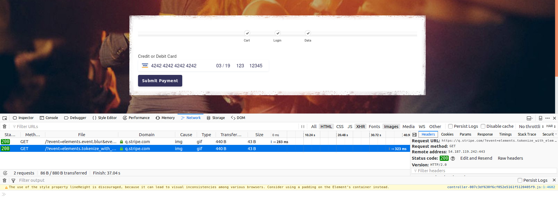

7 years 10 months ago #296529
Thanks for that, that solved the problem. Now the Vendors can connect their Stripe accounts to my Stripe Account.
However I now have problems with the payment itself.
When I click the Stripe button "Submit Payment" (see attached) nothing happens. I can see a get request is being sent (highlighted in blue in the attachment) to Stripe when I click the button but nothing happens after that.
I enabled debug in the payment plugin and checked the payment log file but there is nothing there. I also checked Stripe logs and nothing there
Am I missing any setting in the Stripe account? Do you have an idea about what might be happening?
  • Posts: 128
7 years 10 months ago #296540
There seems to be a problem with the JavaScript in stripeconect_end.php
The var additionalData is not working and blocking the execution.
By replacing
stripe.createToken(card, additionalData).then(function(result) {
by
stripe.createToken(card).then(function(result) {
Now it submits the form, however now I can see a problem in the Stripe logs:
1.Creates the token OK
2. Creates the customer OK
3. Fails when creating the charge, as follows:
  "error": {
    "code": "missing",
    "doc_url": "https://stripe.com/docs/error-codes/missing",
    "message": "Cannot charge a customer that has no active card",
    "param": "card",
    "type": "card_error"
please help, thanks!
