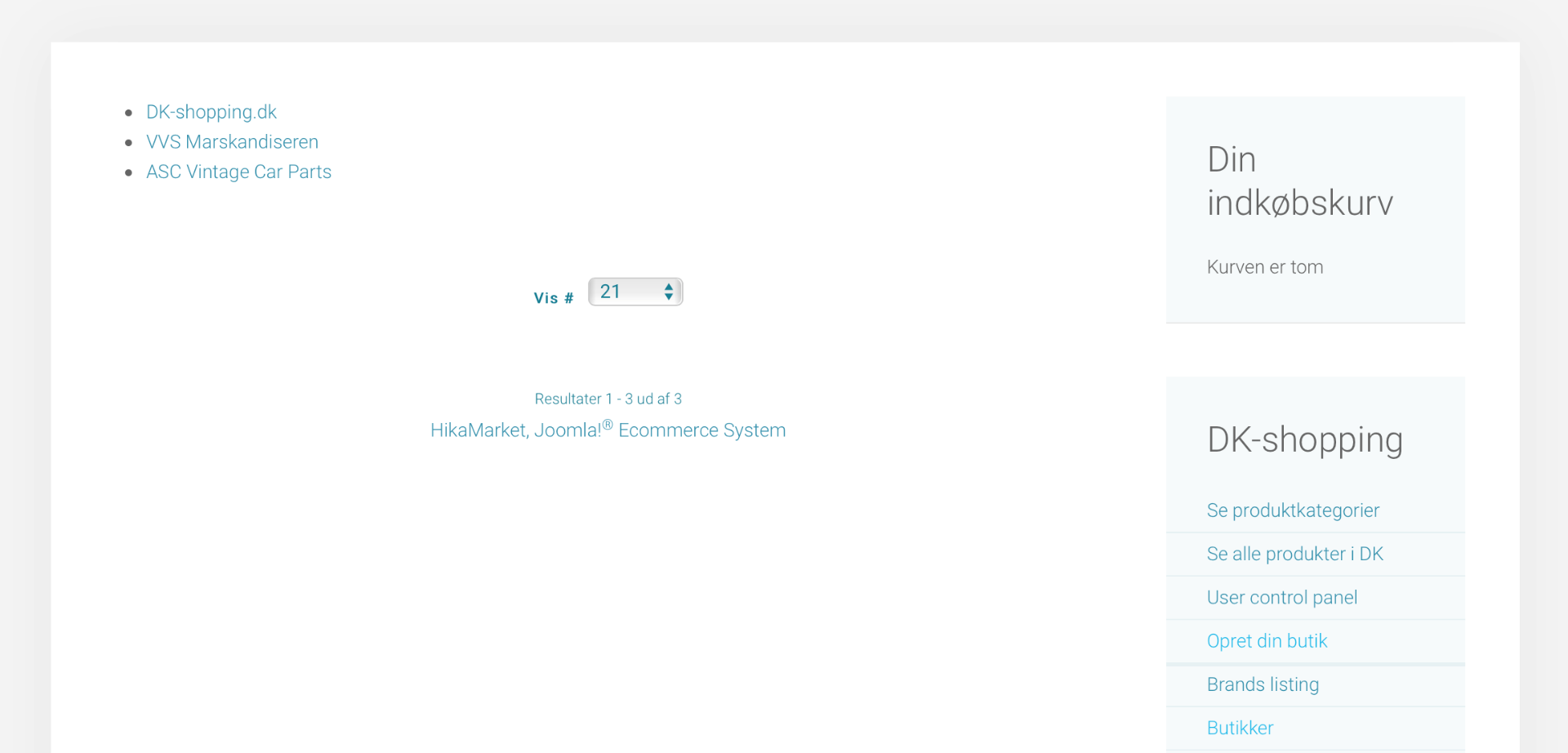

please find attached a screenshot from a Hikamarket we are building.
The sidemenu module is based on the default menu in the Hikamarket, and the menuitem “Butikker” marked with a blue circle is the default vendor listing menuitem COM_HIKAMARKET_VENDORMARKET_VIEW_DEFAULT_TITLE
When you click this menuitem will return the 3 vendors marked with a red circle. The vendors listed are links to the vendor pages.

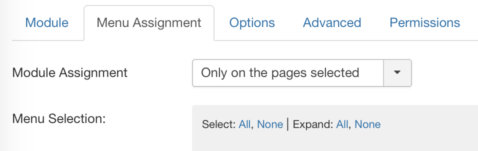

How can we assign modules to these links (they are not visible in the joomla “menu assignment” tap ?

Please configure HikaMarket to use a valid "menu" for the setting "vendor default menu".
www.hikashop.com/support/documentation/1...onfig_market_display
The menu you have configured (with id 937) is not correct so the SEF url is not encoded well.
Once you will have a menu, the URLs will be better and also, you will be able to use that menu for your module assignment.
