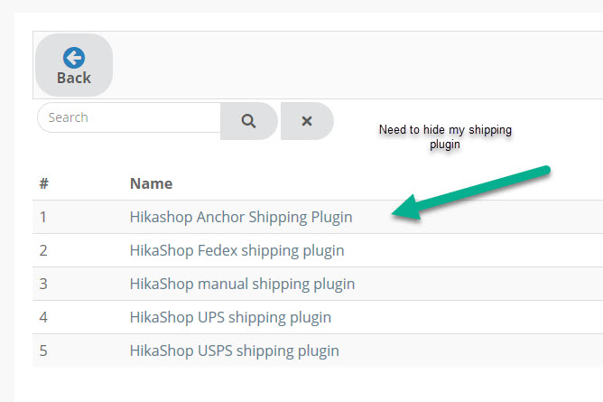

Hello, i have a custom shipping plugin that was created for my store and uses a webservice that connects to my distributor. I just purchased Hikamarket and going through the config now. The shipping plugin that i use for my store is showing under the vendor shipping plugin options also. how do i hide my shipping plugins from my vendors but still use it in my store only. thanks

After looking at your plugin, I realize that the patch I gave you was for the wrong view.
You can of course keep the patch in the "listing" view so you will hide that plugin from the listing BUT you're want to hide it from the plugin creation !
So you need to override the "pluginmarket / add" view and use that code :
  if($this->plugin_type == 'shipping' && isset($row->element) && $row->element == 'XXXX')
    continue;
Just after the line :
foreach($this->plugins as $i => &$row) {

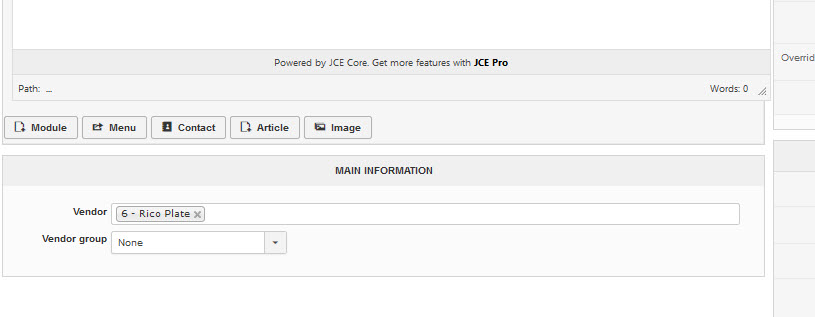

You posted the following
"You need to configure the plugin in the backend if you don't want the shipping instance to be available for other vendors.
Just need to assign the instance to your main vendor."
In the main info area under vendor i listed the vendor, is this correct?

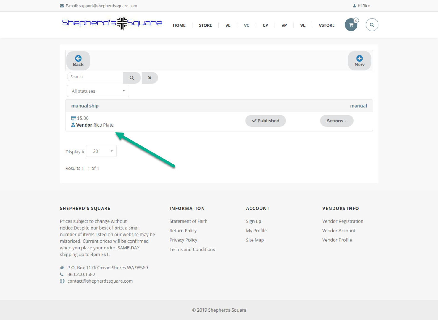

this is from the page where the shipping is suppose to be a manual shipping for a flat rate of 5 dollars.

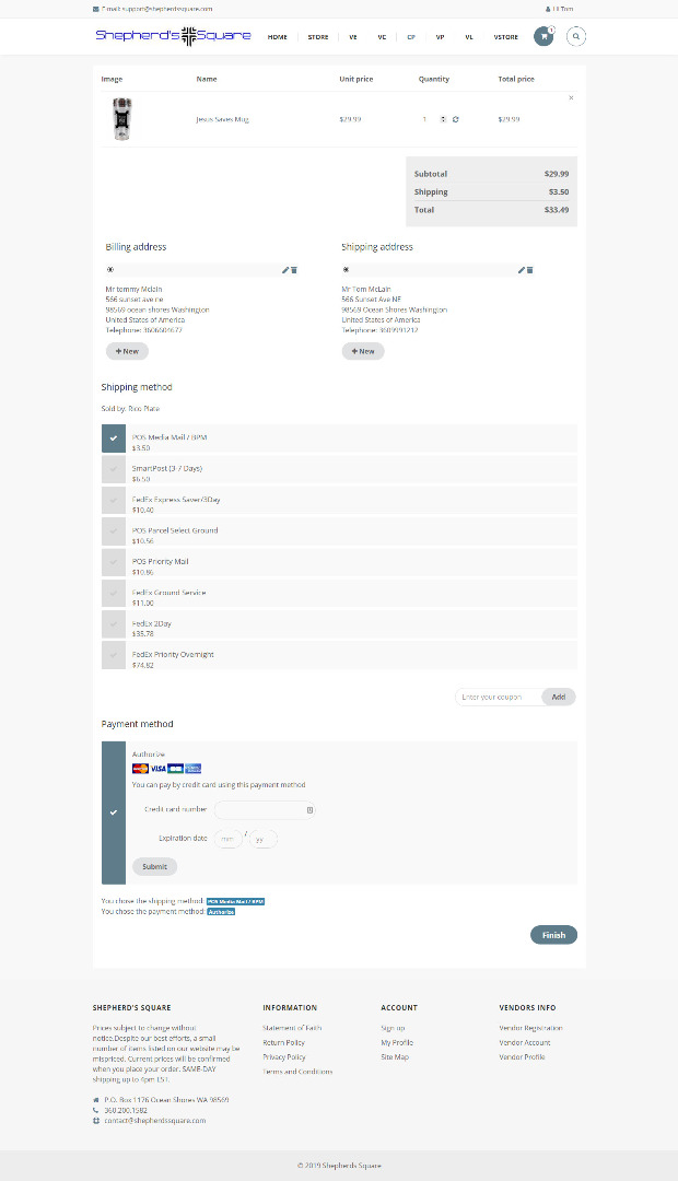

In the vendor control panel where I add the vendors shipping i add the manual shipping but when i put a product in the cart and check out the anchor shipping method always shows up. see attachments.

You have configured your shipping instance to be available just for the vendor "Rico Plate" who have the ID 6.
Your main vendor have the ID "1" and if you set the shipping instance to that vendor, the method won't be used when other vendor products are in the cart.
Because you associated the shipping instance with the vendor, you see that name in the front-end while you're connected with your admin.
Afterwards, the second screenshot is too tiny to be read.
  • Posts: 26355
  • Thank you received: 4068
6 years 11 months ago #308044
After a look at your custom shipping plugin ; the way that is generate its "sub methods" is not the right one.
Official HikaShop shipping plugins which web-services to generate multiple shipping entries are using a define algorithm which consist of copying the "current entry" so it will keep the settings of the shipping method.
Your custom plugin is copying the first available method in the shipping list ; which in your case is your manual shipping method.
So the configuration you set-up for your shipping method is not kept for the duplicated one and it generates unwanted side effect such as the lost of the vendor assignation.
