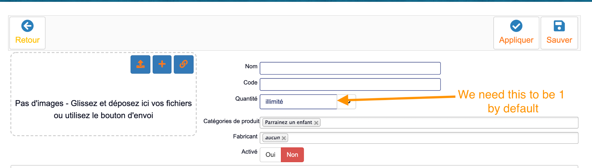

Each of our products is only available in one original unit. How can we make the inventory quantity to be 1 by default in the frontend ?

The easiest solution is to use the "product template" system.
Create a template and set the quantity to "1" ; thus when vendor will create a new product, the default values will be the values you set-up in the used template.

I have created my product template and selected 1 as my default quantity. But when I try to create a product, the quantity still "Illimited"
I think I miss something.
How to make this setup work ?

Did you configured that template as the default template in your HikaMarket configuration ?
