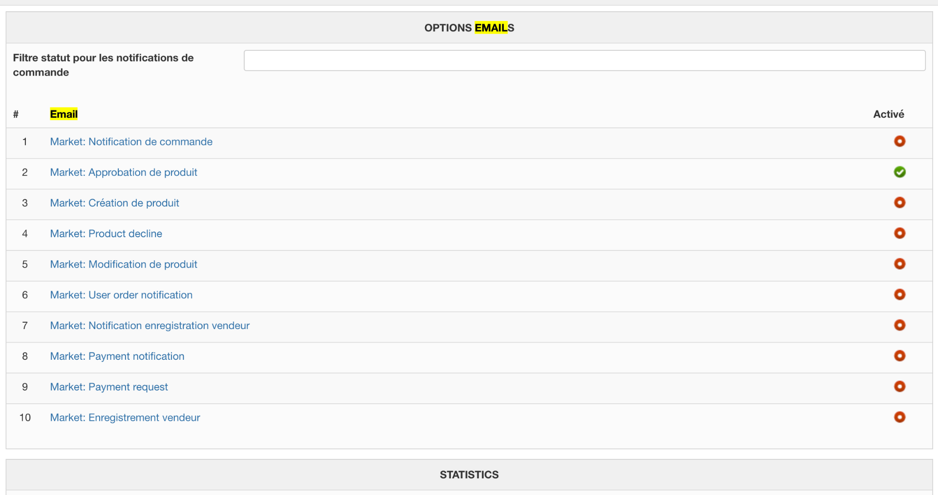

We don't want vendors to receive email after a confirmation order. How do we turn all them off? the reason is that, in our situation for the Arbre de Joie project, they manage only the product creation. Not the orders.
Actually vendors receive confirmation emaiI. But the setup is at OFF
This is the setup in Hikamarket.
Thanks,

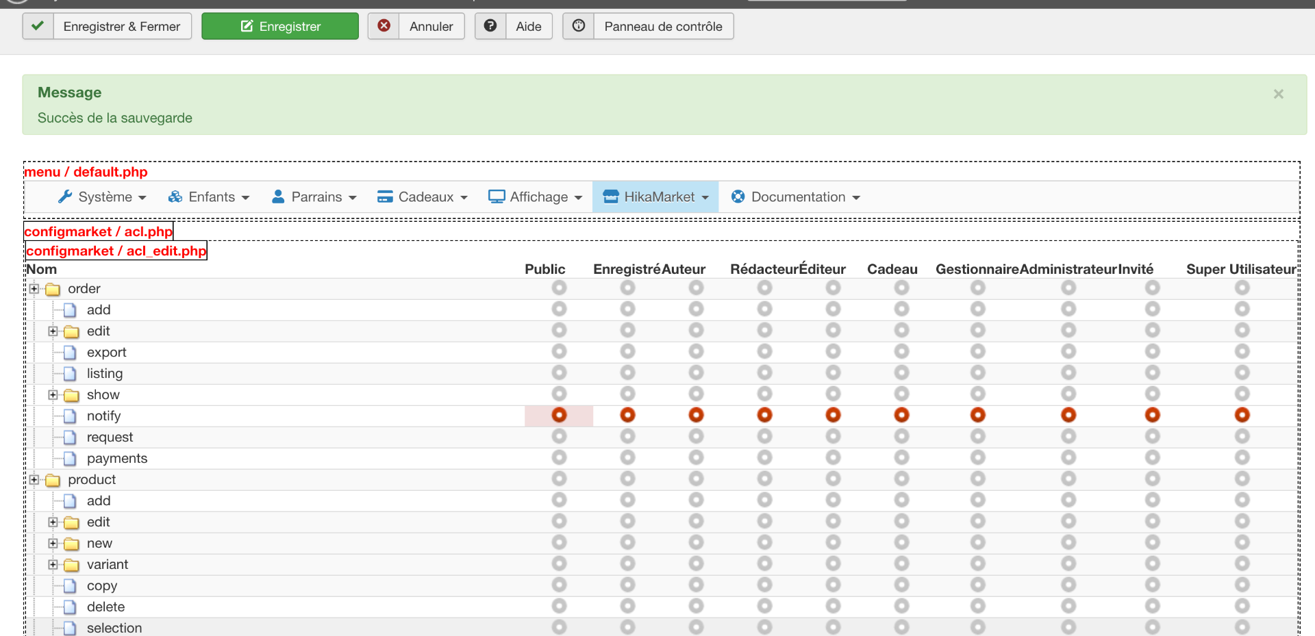

Please edit the HikaMarket ACL and remove the "order / notify" ACL.

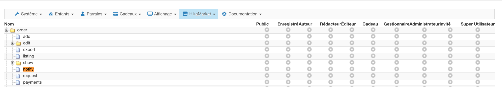

  • Posts: 628
  • Thank you received: 18
5 years 11 months ago #323313
Thank you. I will need a little more information.
I don't see any vendor column and all dots are grey. Which one should I turn off?
Do you have a tutorial on this ACL tool for Hikasmarket?
  • Posts: 26381
5 years 11 months ago #323316
I suppose your ACL are configured in the HikaMarket configuration page (default vendor accesses).
You an use the HikaMarket accesses panel to mark the "order / notify" as "red" ; so the feature will be removed for every groups.

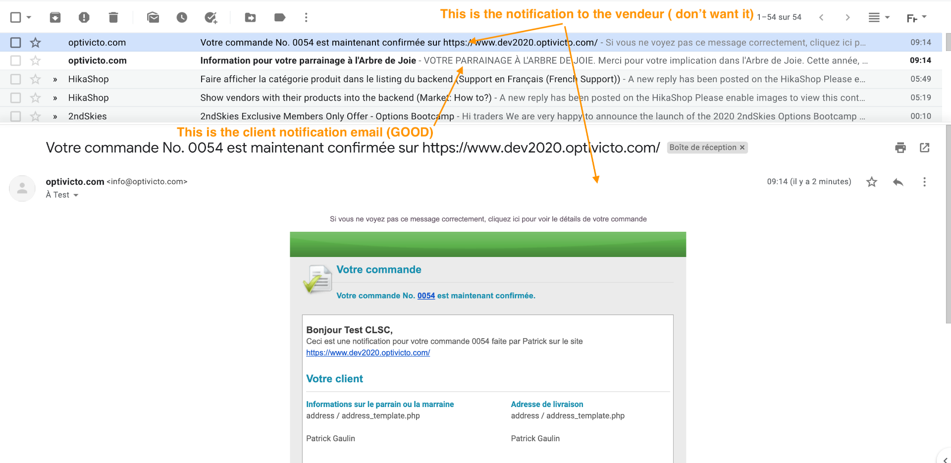

  • Posts: 628
5 years 11 months ago #323368
I tried this and Vendors still receive the notification. What am I missing?
Setup
Result:
Thank you very much

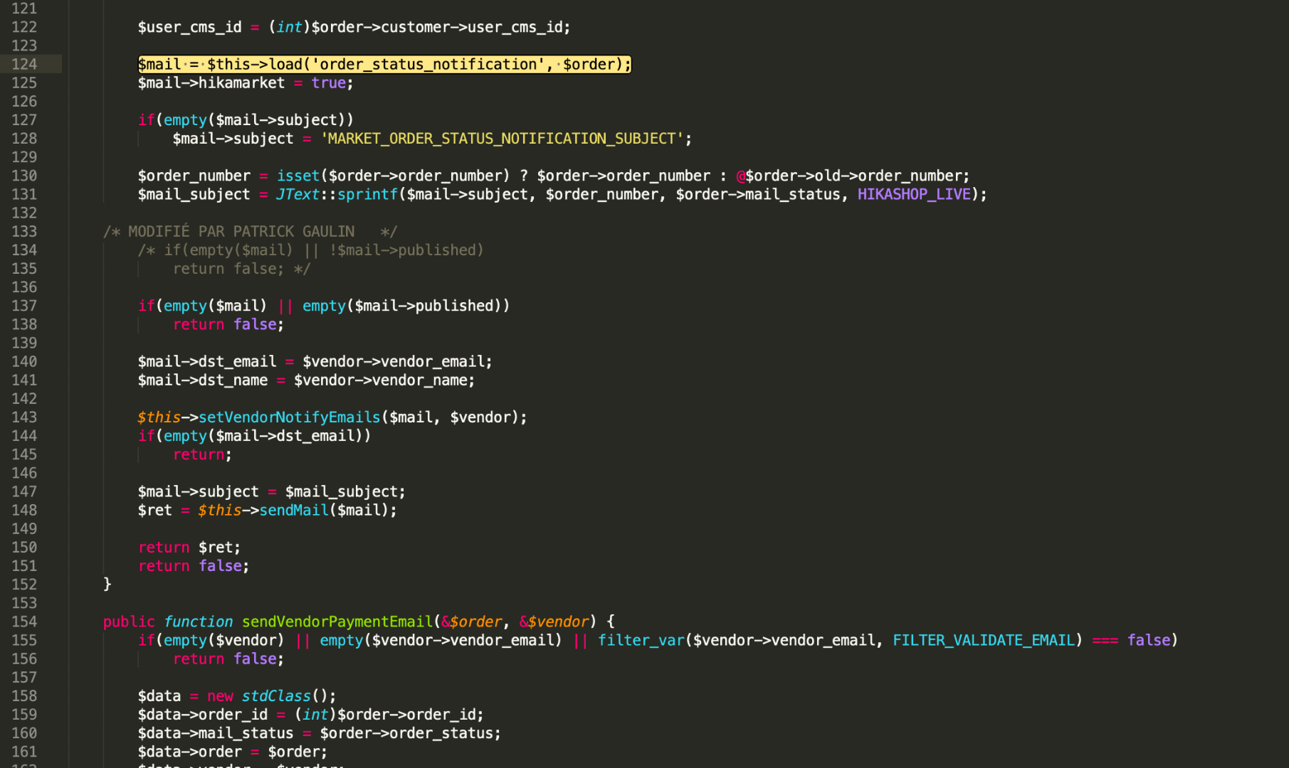

  • Posts: 26381
5 years 11 months ago #323409
In the HikaMarket "mail" class (administrator/components/com_hikamarket/classes/mail.php) you will find the line which load the vendor order status notification :
$mail = $this->load('order_status_notification', $order);
Few lines below, you will see the check for the published status for the email :
		if(empty($mail) || !$mail->published)
			return false;
You can replace that code by
		if(empty($mail) || empty($mail->published))
			return false;
and see if its helps.
But that's the only place in HikaMarket where that email is loaded and processed.

  • Posts: 26381
5 years 11 months ago #323518
Si vous souhaitez désactiver complètement cet email, vous pouvez utiliser le contenu suivant (pour le code cité précédement)
return false;
Ainsi, la fonction s'occupant d'envoyer l'email au vendeur s'arrêtera.

  • Posts: 26381
5 years 11 months ago #323762
Dans mon précédent message je vous indiquait devoir remplacer le contenu entier par simplement un "return false" afin de forcer le refus d'envoyer un email.

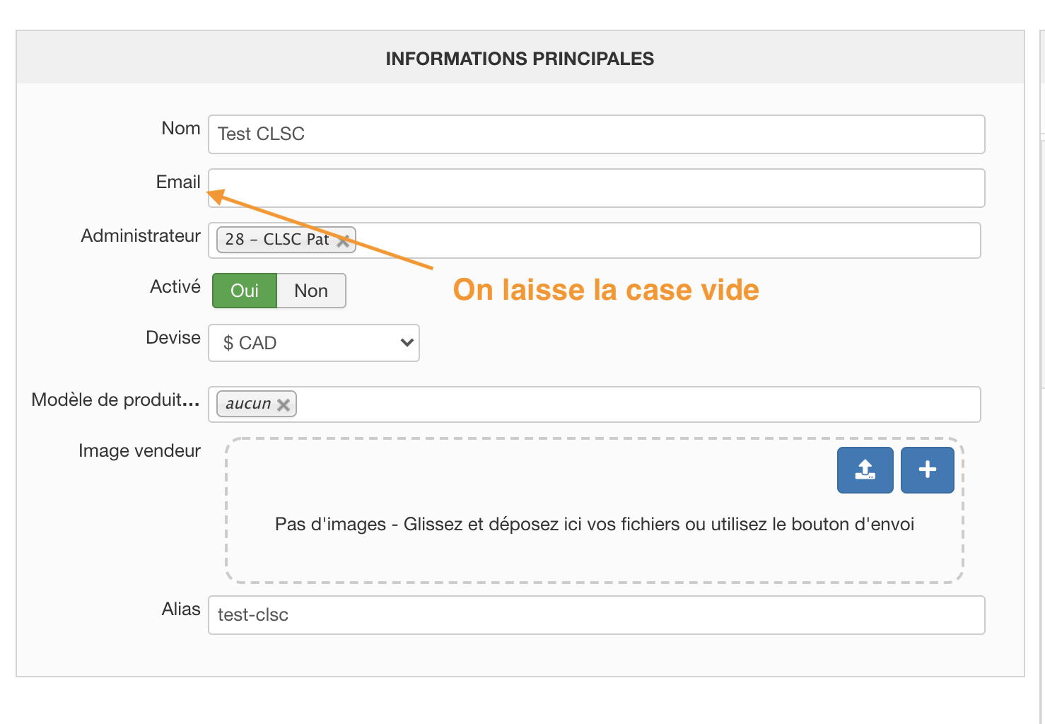

  • Posts: 628
5 years 11 months ago #323903
Je crois avoir trouvé un solution toute simple que ne requiert pas de hack.
J'ai fait un test et ça semble fonctionner mais, j'aimerais avoir votre confirmation que mon approche est fiable.
Dans la section Informations principales des options du vendeur, j'ai effacé l'adresse courriel et voilà! plus de courriel qui s'envoient.
Si je n'ai absolument pas besoin que les vendeur reçoivent les courriel du site, croyez-vous que c'est bon?
Je ne n'aurai pas à me soucier, ainsi, de ce hack lors des mises à jour futures.
  • Posts: 26381
5 years 11 months ago #323908
C'est une solution mais j'avoue ne toujours pas comprendre pourquoi le fait d'avoir dépublié l'email et de ne pas avoir l'ACL configuré, vous permet encore d'envoyer un email à vos vendeurs.
Je n'ai pas réussi à reproduire le soucis sur mes sites de tests.
