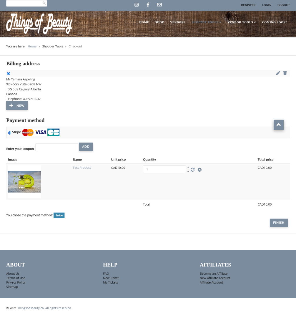

Testing the config. I have shipping set to per vendor, and I have a free shipping option set up on my super admin account, that applies to the whole country. So it should apply to any product I create.
However, when I use another test user to "buy" an item, shipping is not visible in the cart.

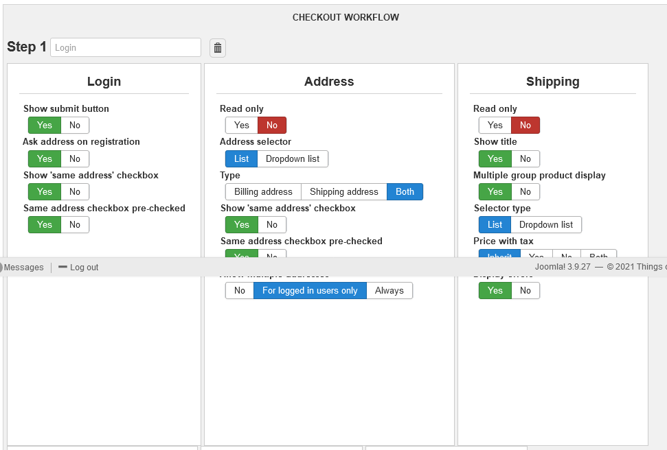

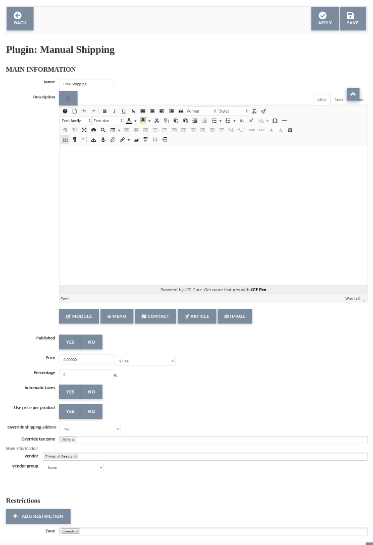

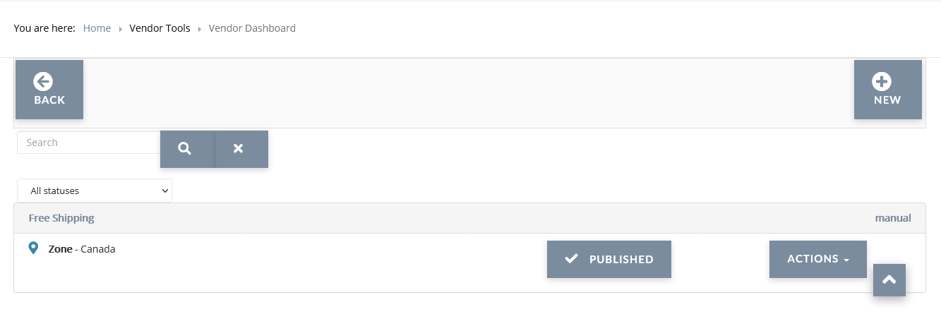

My apologies. I meant checkout. See attached screenshots of the checkout WITHOUT shipping, the checkout workflow from Hikashop WITH shipping, the shipping option setup for the vendor account, and the shipping settings.
As mentioned, even though this shipping option is configured, there are no shipping options showing up on the checkout.
Please advise. Thanks.
