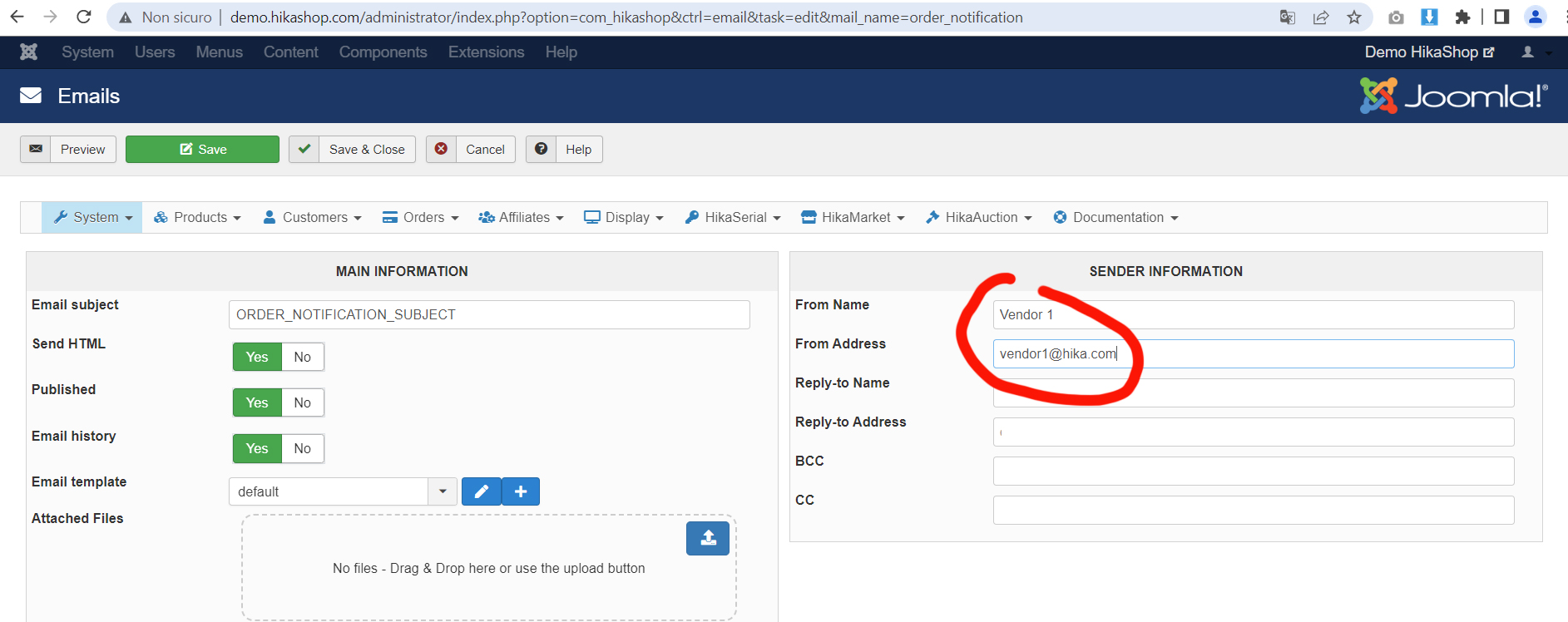

-- HikaShop version -- : 4.7.2
-- HikaMarket version -- : 4.1.1
-- Joomla version -- : 4.3.1
-- PHP version -- : 8.0.28
HIKAMARKET
1) Configuration > Limit vendors in cart > One Vendor
2) Vendor 1, Vendor 2, Vendor 3..
HIKASHOP
1) Configuration > Emails > From Name HIKA, From Address This email address is being protected from spambots. You need JavaScript enabled to view it.
2) Emails > Order creation notification, Order status notification
Messages arriving at the client have HIKA as the sender and This email address is being protected from spambots. You need JavaScript enabled to view it. as the email address
Is it possible to replace them with the Vendor's name and email ??

As I wrote you in another thread, you already have the vendor attributions in the HikaShop mail data.
So you can process them and change the field you want (via an override).
The modification of the "reply" is a good solution to avoid some issues with spam filters ; because sending email as your vendor might not be appreciated by antispams.

I didn't understand which file to override to make the email and the name of the Vendor appear as sender :(

You want to edit the HikaShop order notification email, the one which is sent to the customer.
www.hikashop.com/support/documentation/1...shop-email-form.html

HIKAMARKET
Configuration > Limit vendors in cart > ONE VENDOR
Vendor 1 and Vendor 2
Customer Gerry buy products from Vendor 1
Customer Jerome buy products from Vendor 2
It is possible in the order notification email see the name of the Vendor the customer bought from ?
  • Posts: 26381
3 years 3 months ago #351752
Summary : Yes and you have to override the HikaShop email for that.

Unfortunately my English is bad. I have trouble explaining.
Gerry buy products from Vendor 1. Order notification subject arrives from Vendor 1 (This email address is being protected from spambots. You need JavaScript enabled to view it.)
Jerome buy products from Vendor 2. Jerome will also get the notification from Vendor 1 ;-(

I understand your question but it looks like you're not able to understand my answer.
- No, you must not change the setting of the HikaShop email.
- You want something dynamic : You must use an override via the "preload" part of the email.

I really appreciate your help and patience.
I finally understood, i will edit the preload.php
