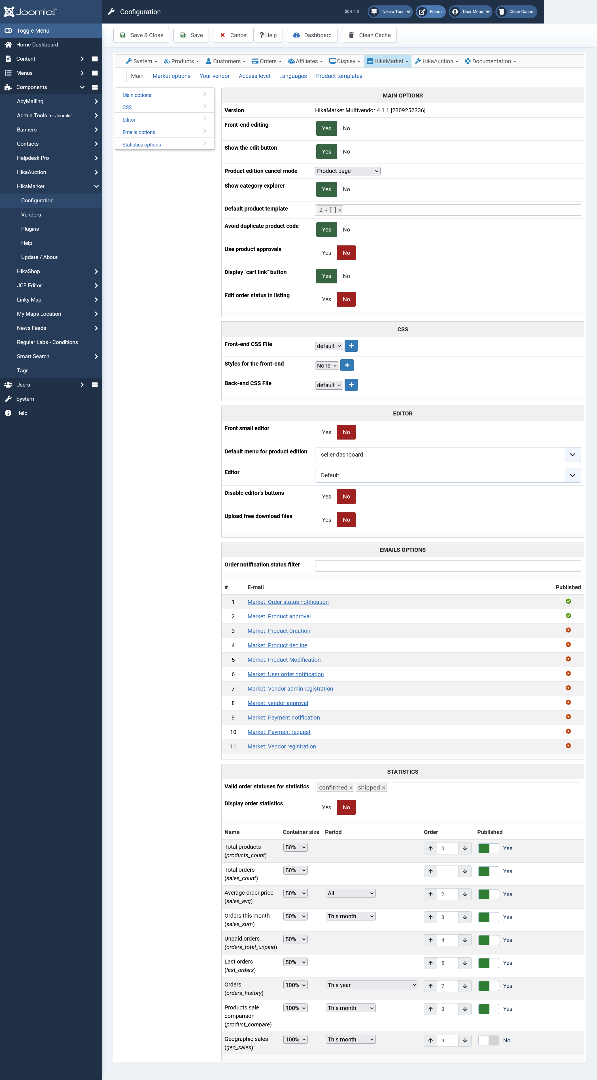

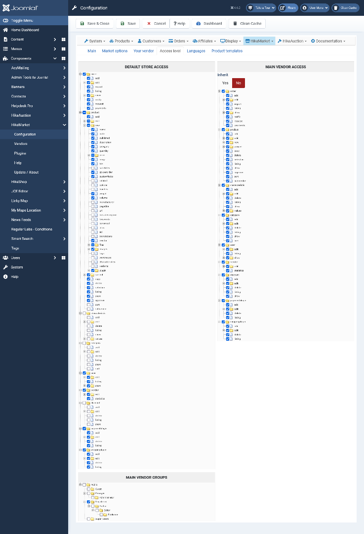

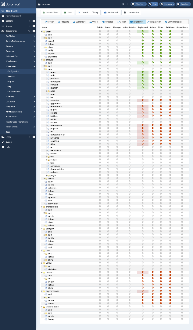

Okay. So here are all the settings.
As you can see in my video (if you bothered to watch it) you cannot add any products from the frontend when you are logged in as a vendor.
Please advise; based on these settings, which ones are not correct? I have tried MANY different configurations, and I cannot make it work.

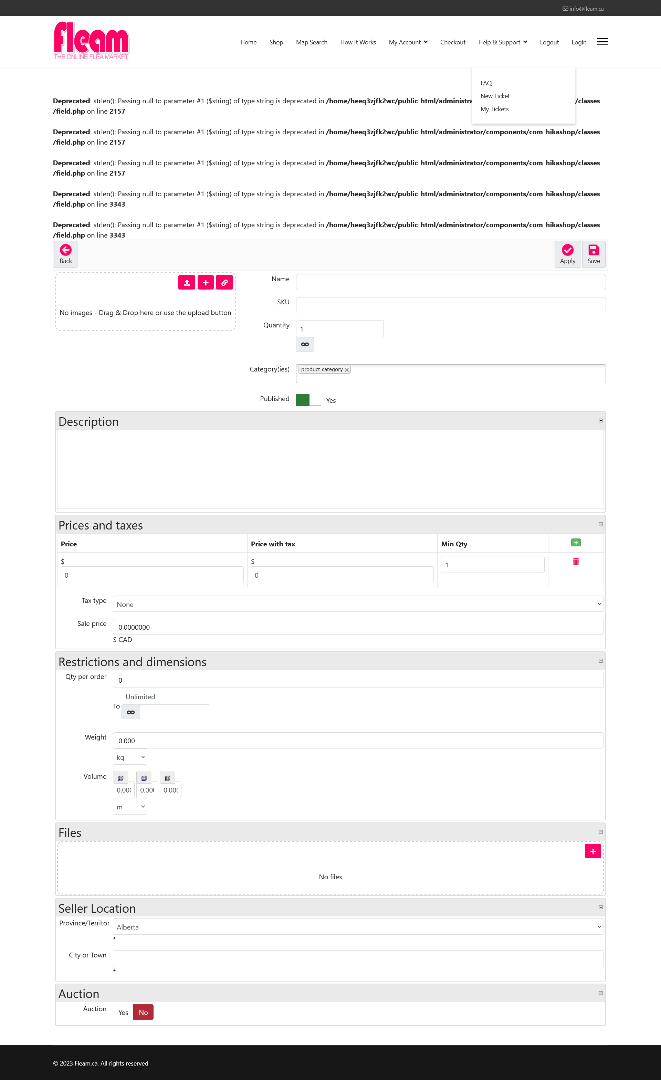

Looks like there are some Hikashop errors on the page.
Could these be the reason I can't edit product descriptions on the frontend?
If so, how do I fix them?
  • Posts: 324
  • Thank you received: 4
2 years 9 months ago #356773
Can you please advise if the deprecated code errors on that page are the reason for front-end editing not working, and if so, how do I fix it?
I've tried every other setting combination I can think of, and it STILL doesn't work, so I'd really appreciate the product support I paid for.
Thanks.

As we can see in your latest screenshot, you have the "text area" to edit the product description.
But you don't have the "wysiwyg editor", like in the Joomla backend.
It can be different things, which is why I asked a specific question in my previous message :
Now, like any other support thread, please provide details regarding your issue ; your versions (Joomla, HikaShop, HikaMarket) and also provide more details regarding editors plugin that you might use.
You issue is not regarding ACL or not having the possibility to edit the product description ; but the fact that the interactive editor is not loading properly.
It could be related to the editor, related to some javascript issues, or other kind of bug.
Please provides configuration details regarding the "editor" section :
www.hikashop.com/support/documentation/1...l#config_main_editor
(Please provide a screenshot which is not resized and too small to be readable)
