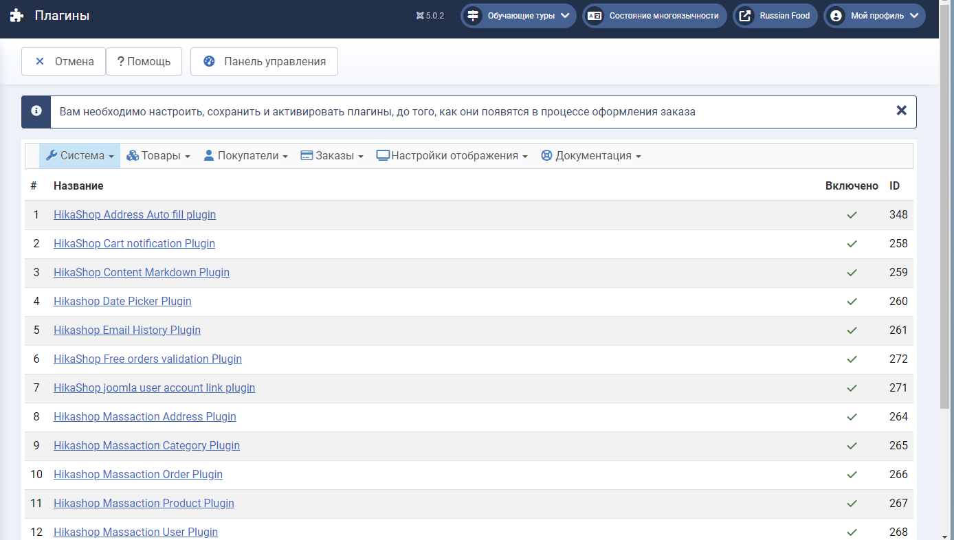

  • Posts: 44
2 years 5 months ago #359571
I can't create a new plugin. A message appears: You need to configure, save and activate plugins before they appear in the checkout process

  • Posts: 44
2 years 5 months ago #359578
Hikashop starter last version

  • Posts: 86058
  • Thank you received: 14182
2 years 5 months ago #359579
The Shop close hours plugin is a plugin exclusive to HikaShop Essential and HikaShop Business.
That's why you get that error.
So you would have to upgrade to be able to use that plugin.
