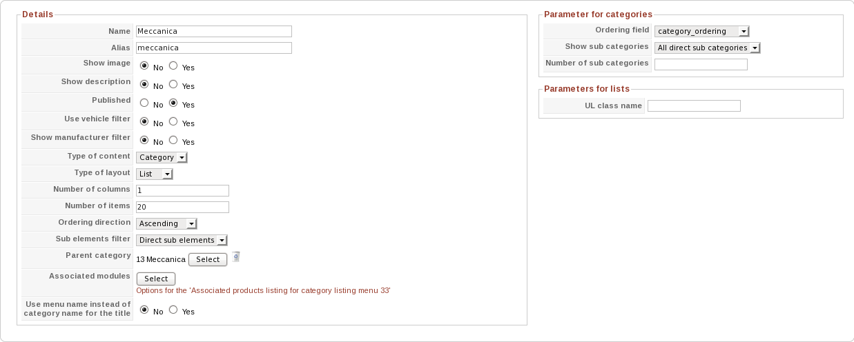

Anyway we go back to edit the menu entry to modify the Parameters for DIV, but this option is not longer visible. See attachment.
Very strange. The only to resolve this problem is to go into the database and the hikashop_config table and cancel the config value for config_namekey 'menu_xx'. You loose all the configuration values for the menu but you can set the Parameters for DIV. Save it and re-enter again and it is not there to modify again.

4) Set the 'Parent Category' so you view the category listing. Click on the 'Subcategory Link' and you will be viewing the Module Associated with the Parent Category Menu. No red background because as I said in my previous post the CSS configuration set in the Menu configuration overrides the values set in the associate module. For me this counter-intuitive. Worse still is that if you go back to configure the 'Parent Category' parameters, because you have set the 'Type of Layout' to list you don't the Parameters for div. And you could mistakenly, as I did, believe that you can not the Parameters for DIV. Anyway if you set the 'Type of Layout' to div for second, change the background colour background to red. Change the 'Type of Layout' back to 'list' and save.
