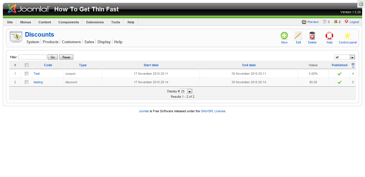

Actually I have a problem on coupons and discounts. The discount did show when I did it at the first time. After I remove it form the admin menu and added new discount and coupon, none of them work. The coupon newer worked. I did follow your other link, which showed that my template should have (I don't remember it anymore) that in the index.php template, and it does. But I don't see any error messages or any discount applied.

15 years 9 months ago #1951
Hi nvidia,
Could you make a screenshot of your discounts listing on the backend ?
Did you apply any restrictions on your discounts/coupons ?
  • Posts: 4
15 years 9 months ago #1991
I just place start date and end date for 5% discount. The site is not finished completely, so you could go and test it:
