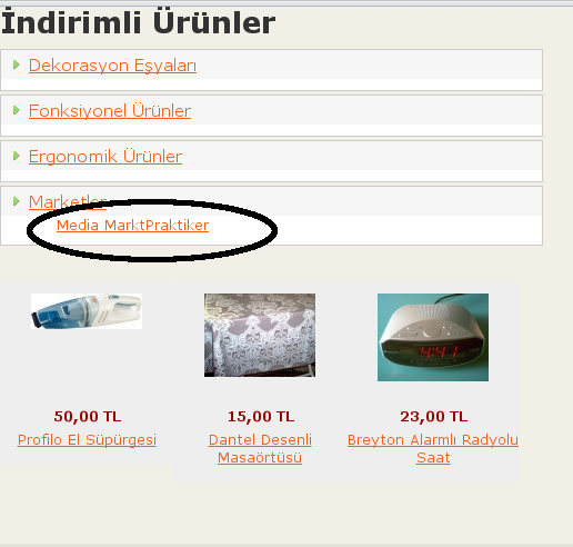

14 years 10 months ago #23552
sub categories is not separate
how can i do?

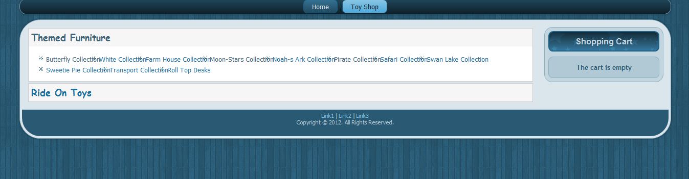

14 years 4 weeks ago #52518
Hi.. I changed the CSS as you suggested and I am still getting a view with the categories not spaced correctly as the screenshot attached.
sub categories don't show at all on this page. What I really want is just a main category and an image for each main category

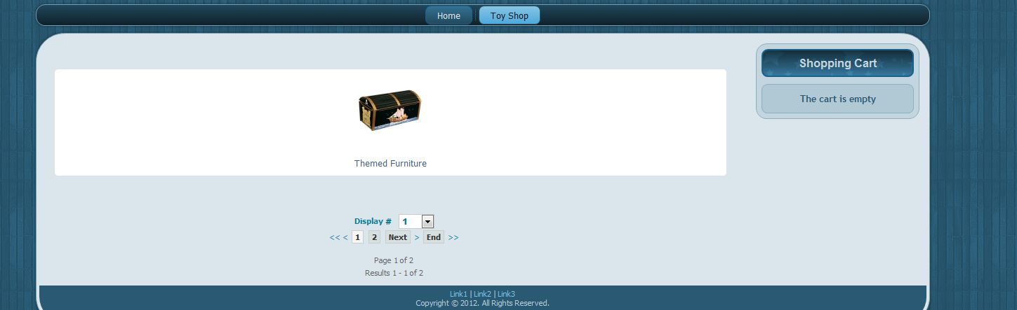

great thanks - I've done that now... but the categories are showing on separate pages. (see attached screenshot) and I would like them to be on the same page. Is this possible? If I manage to do this - apart from altering the font CSS I am really pleased with the way my site is looking. (Thanks to all your help) :)

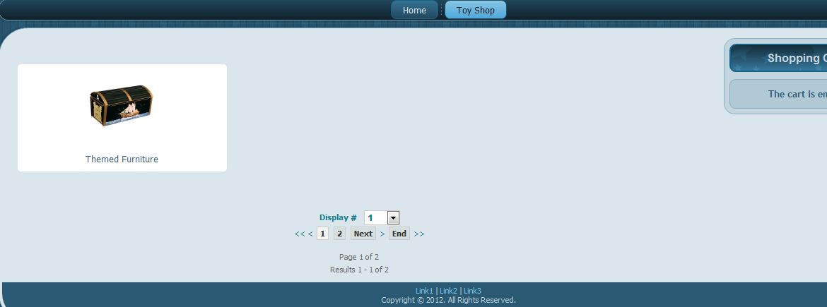

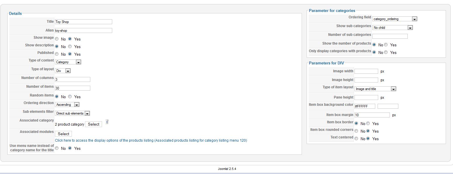

14 years 4 weeks ago #52573
I tried that but I get the result shown in attached screen shot. Have also attached screenshot of my HikaShop options
  • Posts: 76
14 years 4 weeks ago #52575
SORRY!!! I am trying too hard! All I had to do was clear my cookies and everything came up fine! Thanks so much for all your patience and help. I hope to practice what I've learned and when I'm completely confident then purchase the full HikaShop version to make my sites even better. It's a great extension.
