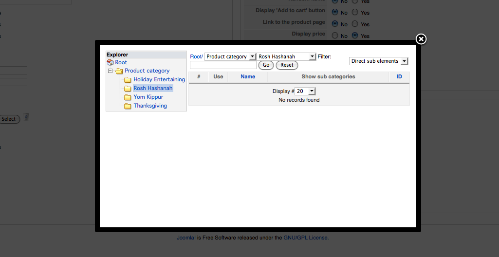

Hikashop 1.5.4
when we go to create a menu item to a product list of a certain category. we click to open the category choice and the modal shows and when we click on the category nothing happens.
its also weirdly defaulting to one particular one no matter what we do. enclosed is a screen shot of the modal. I also have Hika installed on a J1.7 site and when you click the category the modal closes and the category is selected. I was not sure if this worked this way in the 1.5 version or not...

  • Posts: 86096
  • Thank you received: 14200
14 years 10 months ago #27757
When you click on one of the category names on the left explorer, it displays the sub categories of that product on the right listing. As the category does not have any sub categories, you don't see anything on the listing. So far so good.
On your screenshot, you should click on "product category", then on the right listing of categories, you should click on the name of the category (and not in the explorer of the left) and that will add the category.
  • Posts: 102
14 years 10 months ago #27758
yes that it is how it should work... but it doesnt. you click and click and nothing happens. i finally got it to work in Safari. there is no way to take a screen shot of nothing happening...

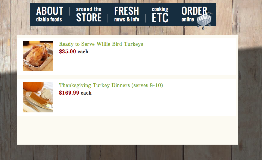

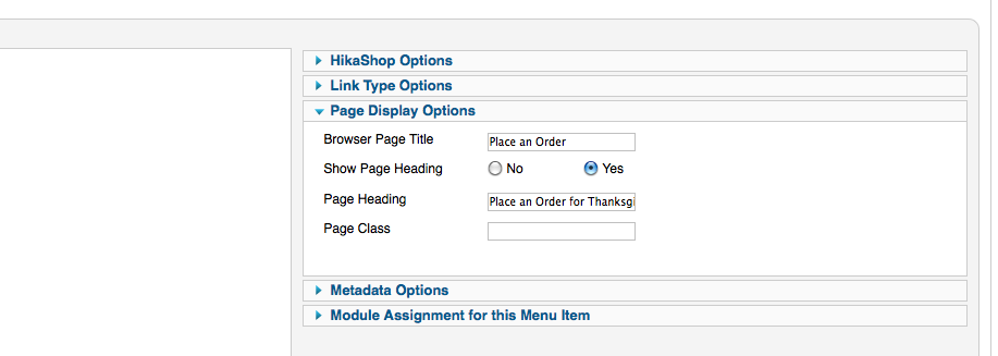

  • Posts: 102
14 years 10 months ago #27771
okay another one for you.. i am trying to display a page heading on a product listing page. i have set the page display options> show page heading to yes and included a heading text. but the page has no heading on it. the browser header works but not the page header.
  • Posts: 86096
14 years 10 months ago #27777
The page heading input text option is not taken into account by HikaShop. HikaShop will either display the current category name or the title of the menu based on the option "Use menu name instead of category name for the title" of your menu.

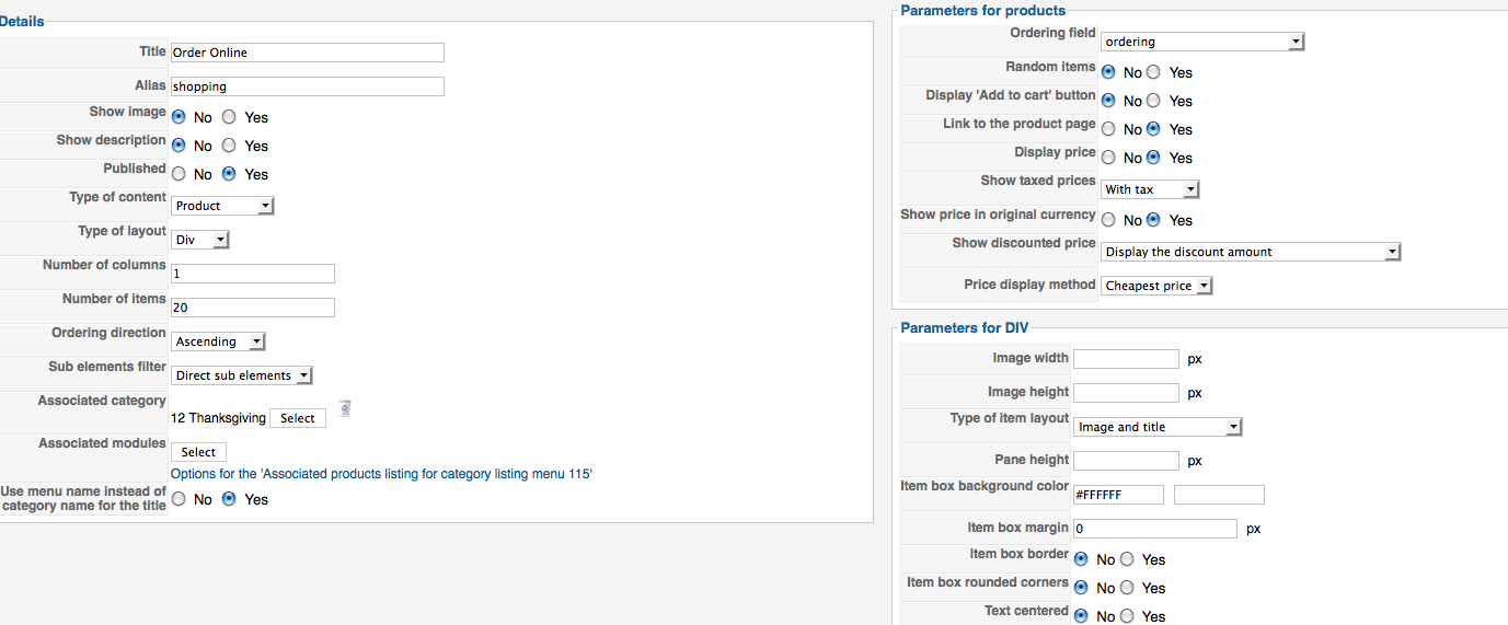

  • Posts: 86096
14 years 10 months ago #27800
Could you do a screenshot of your menu settings ?
  • Posts: 102
14 years 10 months ago #27851
nicolas, here are some screen shots. alternatively, if i could figure out which template controls the main display of that page (and not the item loop) i could just stick a header in the template..

  • Posts: 86096
14 years 10 months ago #27871
Mmm. I'm a bit lost here. What do you mean by "if i insert above the container div a head tag." ?
I see that in your menu's hikashop options, you have a module enabled for the "associated modules" option. For a products listing menu, you don't need an associated module since it's the menu itself which displays the listing of products.
