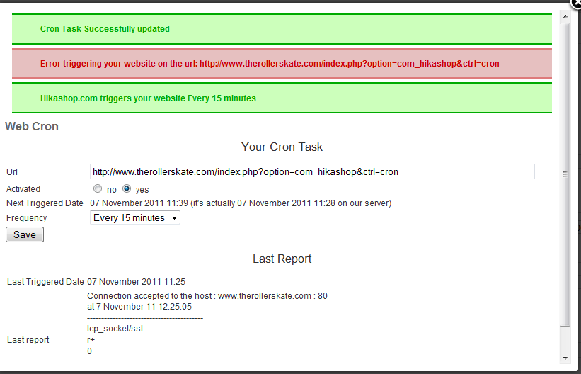

  • Posts: 164
14 years 10 months ago #29296
I think it's all setup correctly, but how do you trigger the cron manually?
Screen shot of an error is attached (probably the same error I had earlier).
Username may have been off, I think I fixed it. But after I fixed the username, the error was still there.
  • Posts: 86099
  • Thank you received: 14200
14 years 10 months ago #29320
That is just a display error on our end. It should be fixed now.
If the products are not updated on google products, it must be something else: the configuration of the google products plugin which is not correct and namely the username and password.
