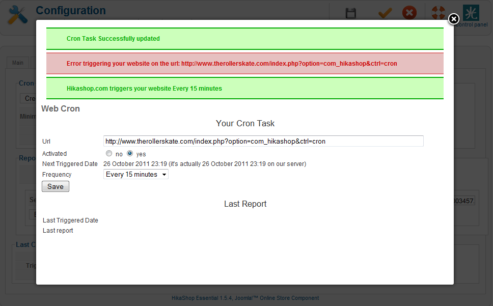

14 years 10 months ago #28334
So, I setup a Cron thingy, and created it, and saved it. But I got this error.
  • Posts: 86094
  • Thank you received: 14197
14 years 10 months ago #28336
Going on www.therollerskate.com/index.php?option=com_hikashop&ctrl=cron
I can see that your cron was triggered.
So it seems to be working.
You can check that in more details by following the documentation there:
www.hikashop.com/en/support/documentatio...cron-task.html#check

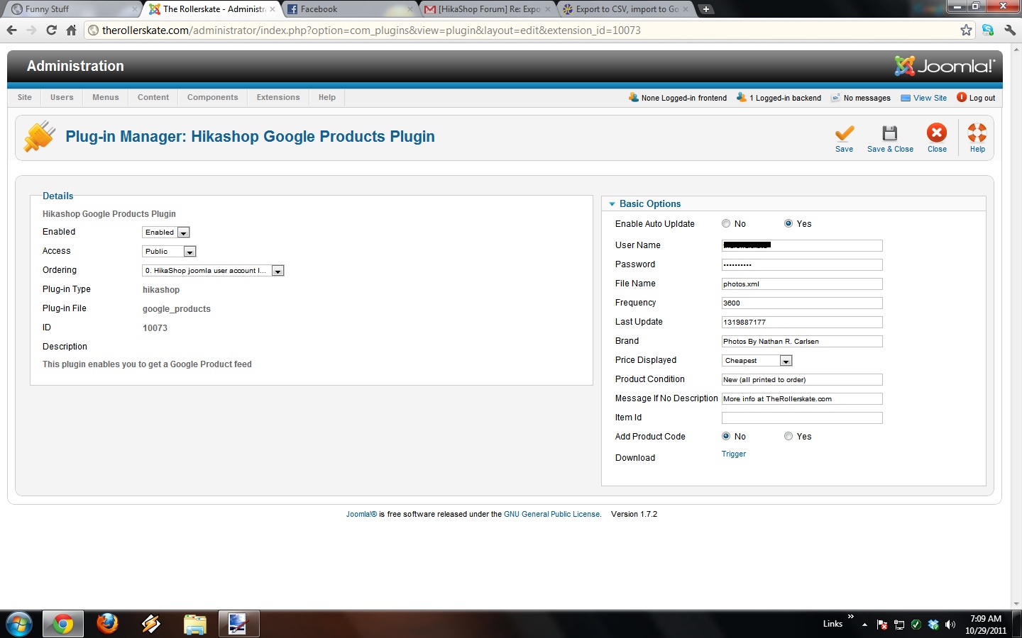

Are you sure that you cron is working ?
Did you set the cron system to send you an email each time it is triggered and did you receive the emails ?
Could you do a screenshot of the plugin's options (you can grey out the password/username)
  • Posts: 164
14 years 10 months ago #28528
I think I got everything setup correctly now, but I still don't see any products in Google Merchant. I feel like I may have missed something.
  • Posts: 164
14 years 10 months ago #28569
No, I am not receiving the cron emails, even though it is saying that it is working by giving a last run time. Attached is the plugin screen shot.
  • Posts: 86094
14 years 10 months ago #28582
What if you update your google products on your merchant account using the xml that you can download via the trigger link on that screen ? Does it displays any errors ?
Do you have any errors or messages regarding that photos.xml file on your google merchant account ?
