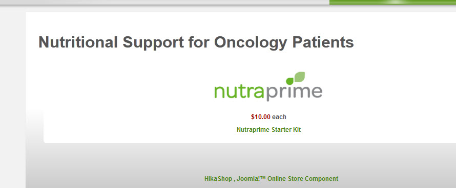

The category name is displayed just like a normal H1 text as defined in your template CSS.
If you want to display it differently you will need to add/change the CSS. If you want to center it, you can use that CSS:
.hikashop_products_listing_main h1{ text-align:center !important; }

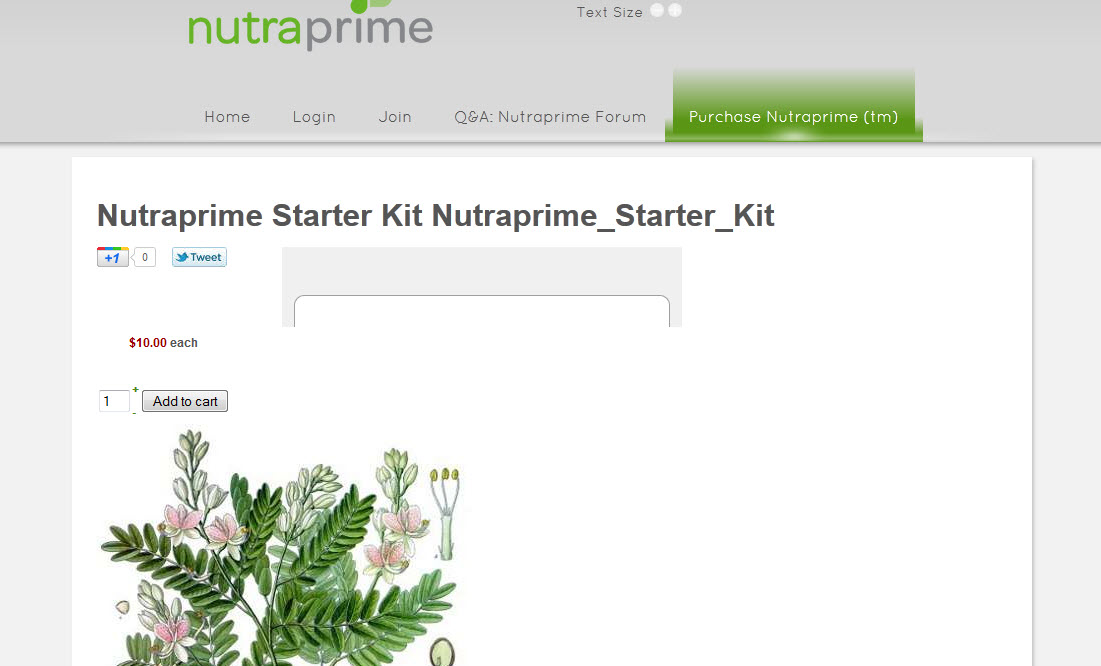

For the weird error, I actually don't see it from here. That's the place where you have the facebook iframe. So apparently there is something which blocks facebook on your end.

I get a weird display error on my site www.nutraseries.com during the 'buy nutraprime' checkout process.
In the first step, the category name appears offset out of line.. and there is a weird 'error' displaying a partial shaded/rounded box - I can't figure out what THAT is coming from either.
Any thoughts? Please email me.
