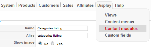

It's in Components -> Hikashop. Once there, under the title of the page, you have a menu Display->Content menus.
Here is an example: www.hikashop.com/media/doc/tuto_content_options_module_menu.png
