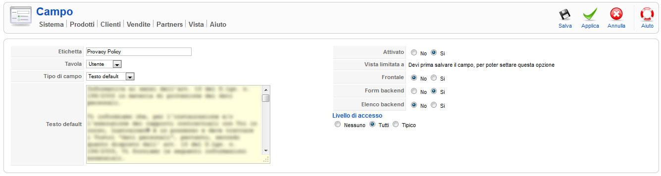

Up to my previous post.
I've done a test over a Business version of a Client and I have same result. Here is the screenshot:

14 years 8 months ago #31465
Thank you for the information.
Please change the line:
echo $this->field->field_type;
to:
echo $this->field->field_type.'<input type="hidden" name="data[field][field_type]" value="'.$this->field->field_type.'" />';
in the file "form" of the view "field" via the menu Display->Views and try again. That should solve the problem.
