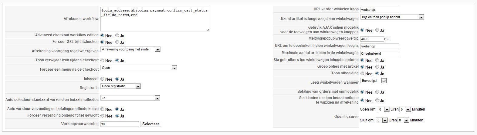

OK, see the screenprint attached :

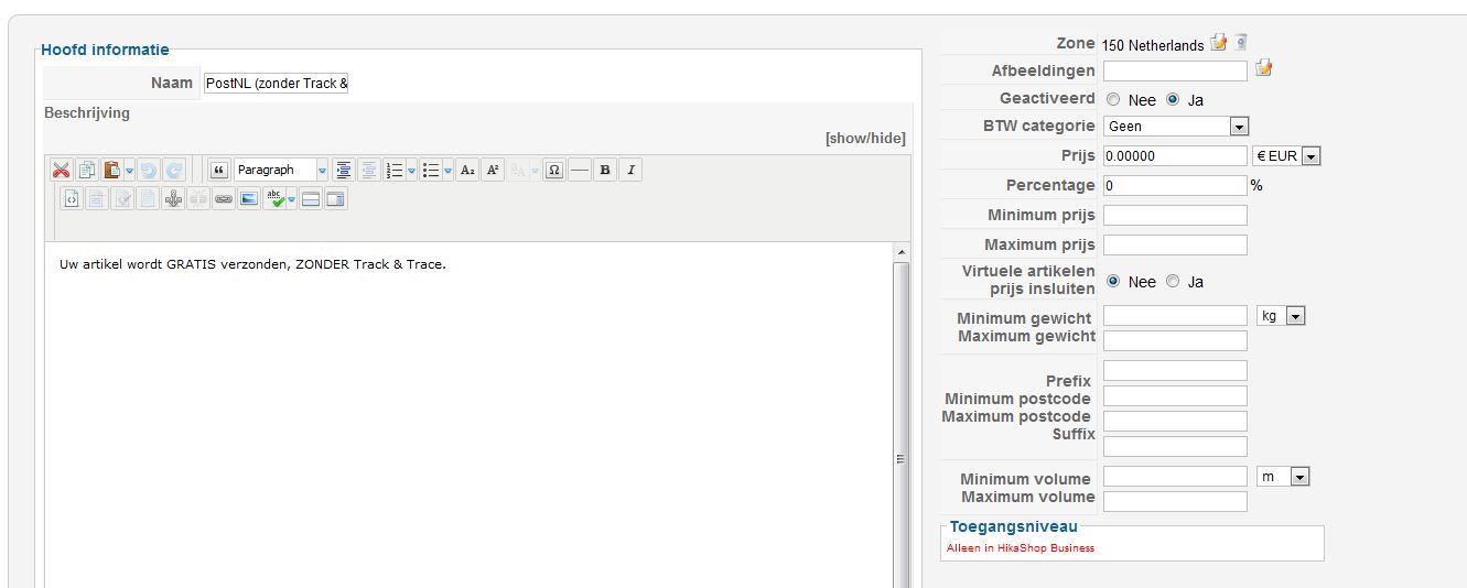

Other configurations that might be of interest: Shipping is done using "HikaShop manual shipping plugin", in 2 variants, both for NL only. see a screenprint for one:
As I said, it all worked before, so it almost feels as if something is corrupt in the configuration...

Could you try to activate the auto select and auto submit options and try again ?
  • Posts: 135
14 years 8 months ago #33107

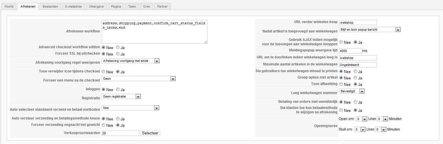

I have updated the configuration as per your suggestion. I now also saw a message that my checkout workflow is incorrect, as I cannot have address without login. Not quite how I would want it, but maybe that's something I do not fully understand, I will check the documentation for that.
The checkout now seems to work though, so thanks for that. I still see some minor things, but for now I'm happy, so thanks for the support!

I have been busy setting up my shop, and for the most I'm quite happy with Hikashop, except for this issue. Using the advised settings the checkout process works fine, but I find that auto-selecting and -sending works confusing, it is not the behaviour that a user would expect.
I have tried setting the parameters for autosend and autosubmit back to "No", but this results in the checkout looping again.
Is there a way to correctly set these parameters, or is this a bug?
