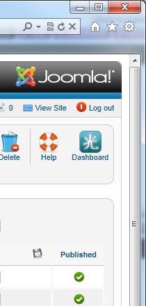

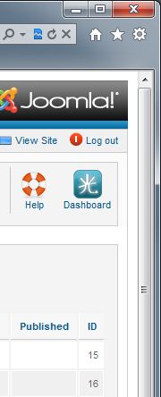

13 years 8 months ago #81414
Could you provide an image screenshot of your problem ?

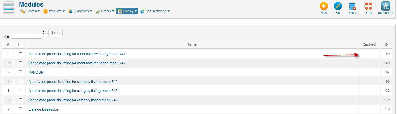

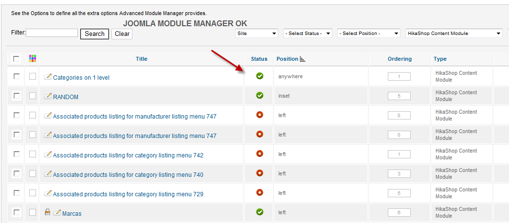

  • Posts: 19
13 years 8 months ago #81429
First is within Hikashop
Second is from the Joomla Module manager
13 years 8 months ago #81557
This is a browser issue.
Please remove the "compatibility mode" of Internet Explorer.
