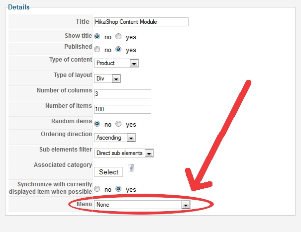

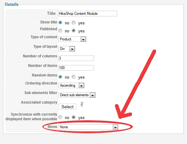

  • Posts: 8
14 years 2 months ago #45783
I found a solution:
At Hikashop Content module for the carousel i Had enabled the synchronize option but i had made a selection for menu field. Removing this selection (selected "none") solved the problem.
See the attached image
