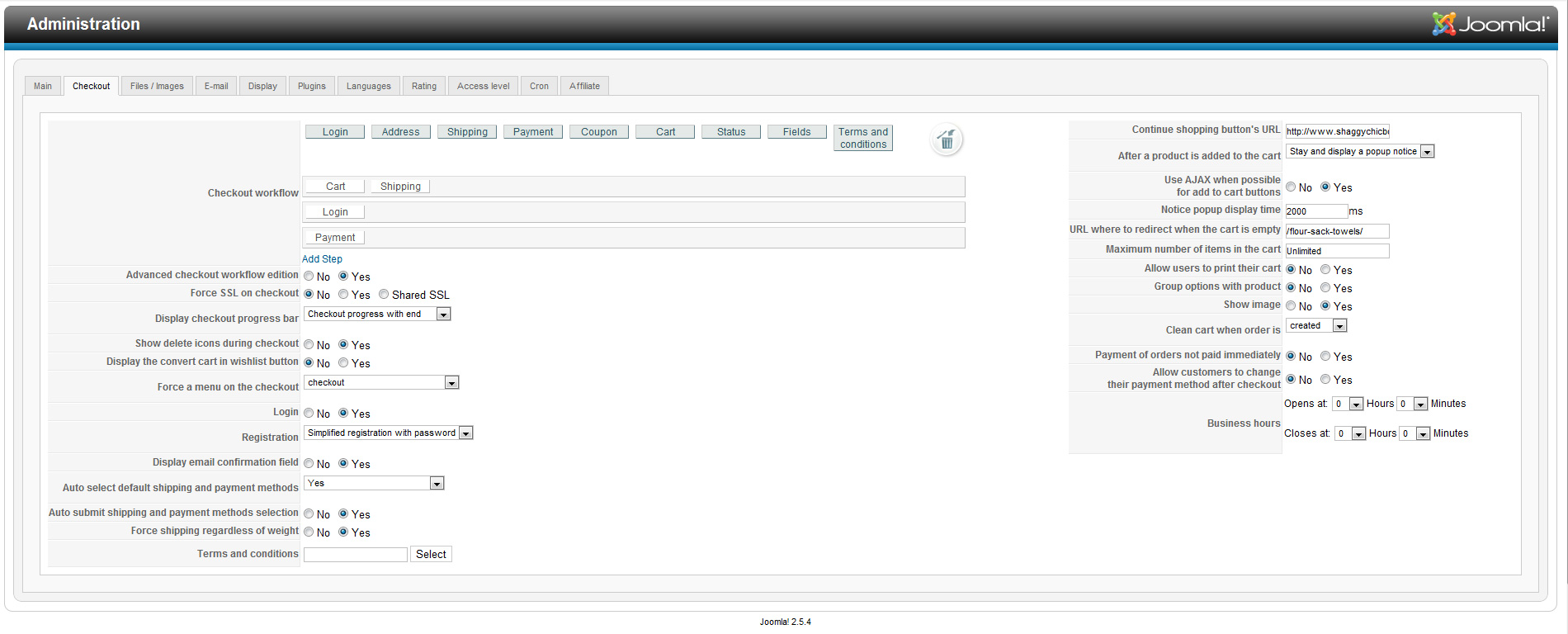

Mmm. I don't see why that would happen. Could you do a screenshot of the checkout tab of the configuration ?
  • Posts: 53
13 years 11 months ago #66158
Here you go:
The login info also works on the backend FYI.
  • Posts: 86094
