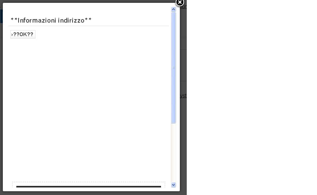

  • Posts: 10
14 years 3 months ago #53608
hi, i have the same problem of this discussion
www.hikashop.com/en/forum/3-bug-report/5...pup-not-working.html
i attach one picture
thanks
i have this problem with any browser
  • Posts: 86211
14 years 3 months ago #53696
Then try the same solution :
Unpublish the address_street2 custom field via the menu Display->Custom fields and that will solve the problem.
Instead, you can create a field with a different column name in order to do the same.

  • Posts: 10
14 years 3 months ago #53791
the query
SELECT *
FROM ta_hikashop_field as a
WHERE a.`field_published` = 1
AND a.`field_backend` = 1
AND a.field_namekey!='address_name'
AND a.field_table='address'
ORDER BY a.`field_ordering` ASC
return 0 result
  • Posts: 86211
14 years 3 months ago #53865
Download and install again HikaShop and that should solve the problem.
The following user(s) said Thank You: liberoc
  • Posts: 10
14 years 3 months ago #53933
thanks, now go!
