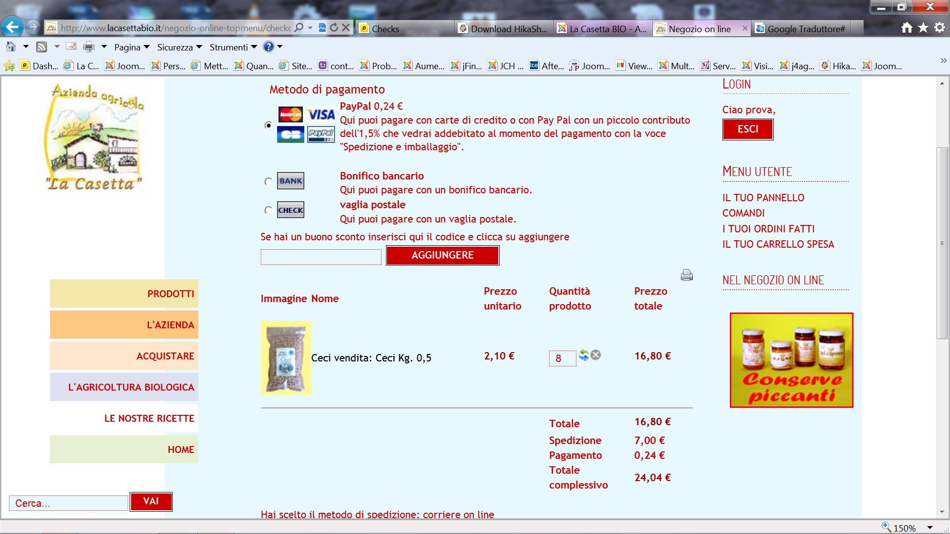

  • Posts: 719
14 years 2 months ago #53776
Ok, I updated it. Pay Pal is ok now.
But the calculation of the percentage still does not work well.
The system calculates the percentage only on purchases and not on purchases+shipping.
Here is a screenshot. I set the percentage on 1.5%.
The system give me Euro 0,24. It should be Euro 0,36 (16,80+7=23,80 * 1.5%= 0.36)
my site with Hikashop
www.lacasettabio.it
  • Posts: 86091
  • Thank you received: 14196
14 years 2 months ago #53789
Ok, I checked and there is indeed a problem with the payment fees, but it's not a problem with taxes. It's just that it rounds the percentage before applying it.
You can download and install again HikaShop to fix the problem.
