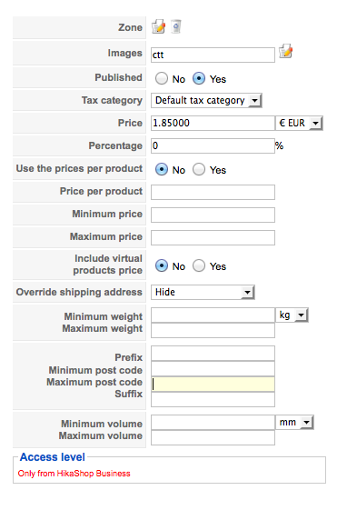

In the shipping methods, i delete all of them and create a new one for testing:

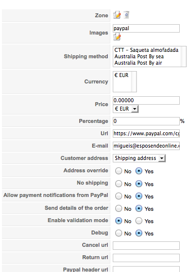

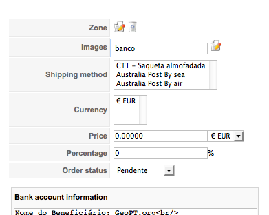

Can you do a screenshot of your payment plugin's options ?
  • Posts: 41
14 years 2 months ago #55780
Here

  • Posts: 86091
  • Thank you received: 14196
14 years 2 months ago #55784
That's all good.
I checked again your website and I can now see both the shipping and the payment method on your checkout. It seems that it's working.
