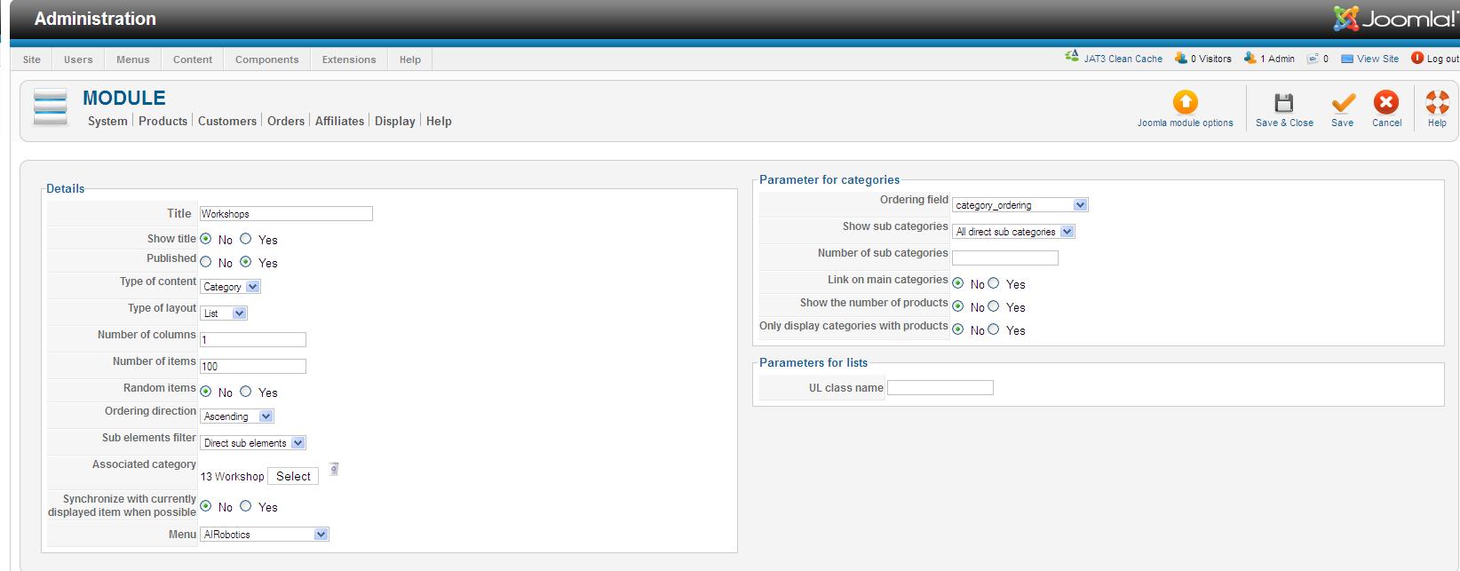

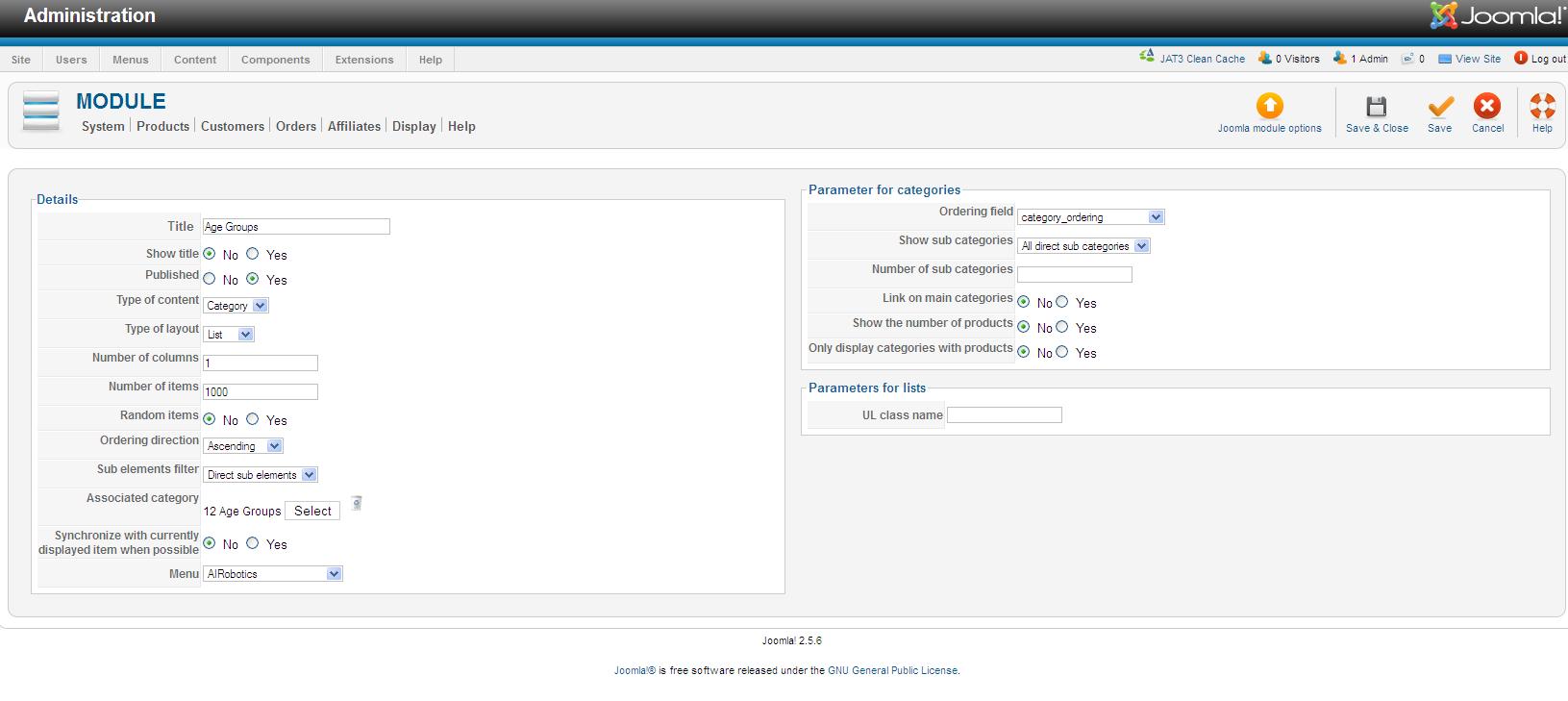

However the 2nd problem remains. When I click on "Event Series" under Workshop, followed by "Lantern Festival", the active highlighted tab becomes something else instead of "Event Series". It only happens to the categories found inside the "Workshop" box. As you can see, the categories found inside the "Workshop" box belong to a different parent category from that of the ones found inside "Age Group" box. For this feature to work properly, am I allowed to display more than 1 hikashop_content_module on the same page?

I got it. I was actually testing that at the moment and found that that the algorithm is correct in HikaShop.
I went online and indeed found out that the JPane system of Joomla doesn't allow for default openings when more than one of them are displayed on the page:
forum.joomla.org/viewtopic.php?t=493263
So it's actually a joomla problem. The solution proposed there should fix the problem for you but that will require that you hack the joomla JPane library and the file "listing_list" of the "category" view in HikaShop (in order to call it differently).
Thus I would recommend to not have more than one Pane on your pages.
If you want to display two categories listing modules on a page, you can try to either use another accordion module like this one:
extensions.joomla.org/extensions/extensi...hop-extensions/21225
or change the "Show sub categories" option of your module so that it doesn't use the accordion effect of joomla.
