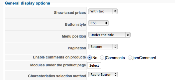

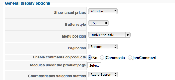

I want to create a "Related Products" module to show at the bottom of the product page.
I have created the module as per instructions but when I am in Configuration/Display and when I am trying to select the module it will not take.
Nothing is showing up after the select button after I have selected the module. And consequently no related products show up either.

Once you selected a module it's normal that nothing appears.
You have to save the configuration to apply these setting and you'll see the a link to the module under the select button.

Yes I got it working now but the tricky part that fooled me was that when I select the module after hitting the Select button, my browser opens a new Tab, I didn't notice that. Then when going back to Hikashop Settings the Select command and saving wasn't done from the right session.
When I figured this out and went back to the original tab and saved the config I got it to work.

13 years 10 months ago #61864
Clicking on the module's name open the module's parametre in a new page.
To associate the module you have to set the publish paramtre to "yes" (in your popup on the right) and then click "OK".
