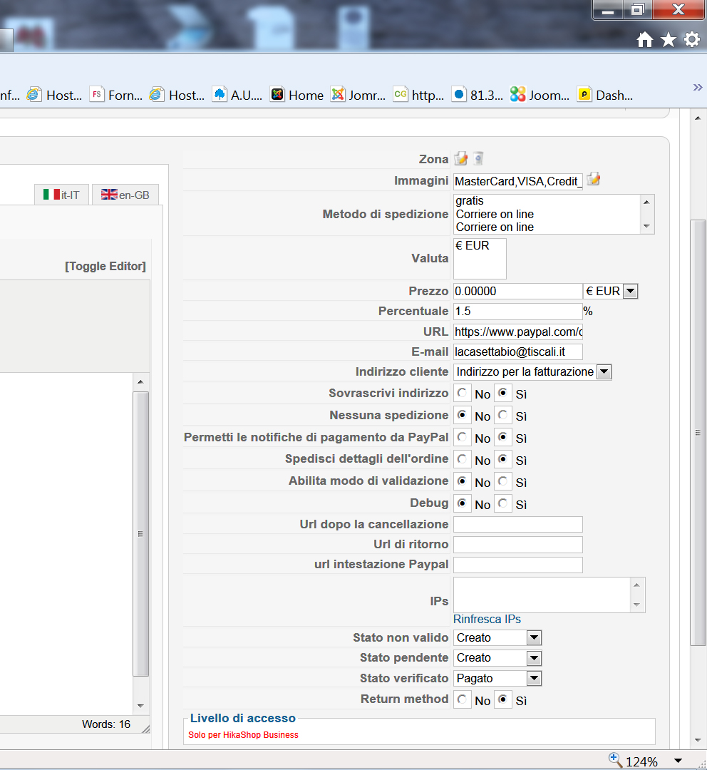

13 years 11 months ago #62322
can you send me a screenshot of your Paypal configuration ?
  • Posts: 719
13 years 11 months ago #62341
here you are!
my site with Hikashop
www.lacasettabio.it
