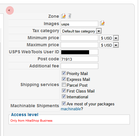

13 years 11 months ago #62844
Can you test it with weight into your variants and without the "Force shipping regardless of weight", then if the UPS method don't show can you send me a screenshot of your UPS configuration ?

13 years 11 months ago #62854
Sorry I misunderstood :
If you force the weight values into those two variants, copying them from the main product, the plugin suddenly shows up and starts working.
The UPS plugin doesn't appear to have this problem.
We are working on it and will fix it tonight if everything goes fine.

13 years 11 months ago #62914
We published the new build and it should work now. Please download and install HikaShop again.
