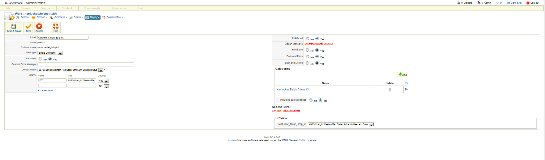

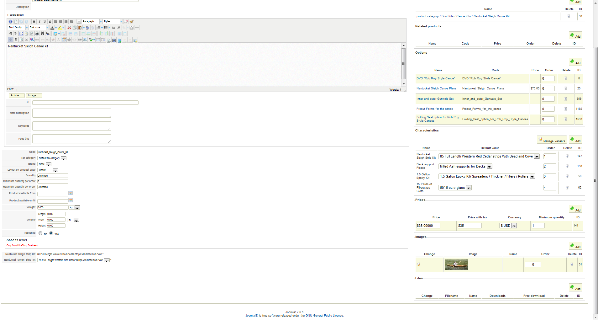

I tried what you said and set up two product custom fields on the back end. One a special text field and one a drop down. to see how they would work. They both show up on the backend, but neither shows up on the front end.
I did this using the same page you referenced below so that you could see. I have also attached page grabs of one of the custom fields as well as the product page from the back end so that you could see what is going on.
What do you need to do to actually make them show up?

Custom fields of the type "custom text" just allow you to display text on the product edition page. You don't need that.
You want dropdowns.
Once you created the custom field, you need to edit the products, select the value you want for the custom field and save the product.
That will display the value on the product page on the front end automatically. If you don't see it, it might come from some caching activated on your website.
